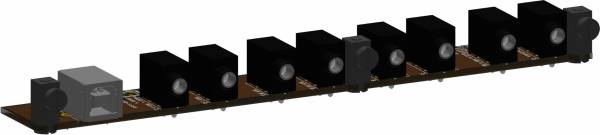

I made this Breakout-PCB and Frontpanel for the midiphy LoopA midiphy LoopA

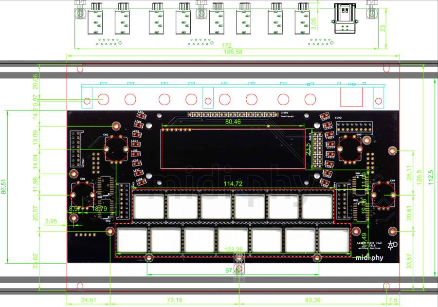

PCB Size is 172x24mm

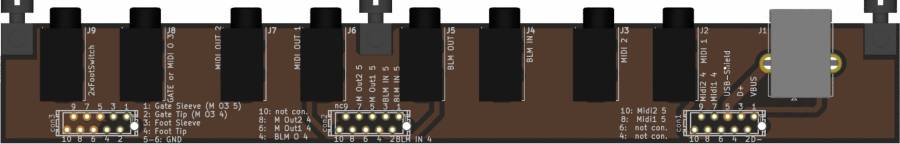

You have to decide if you want Midi Out 3 or the Gate OUT (space thing)
The Reset Switch and the SD, Card, are still on the base PCB…
If you want use the PCB you dont have place for the stock DIN Sockets!

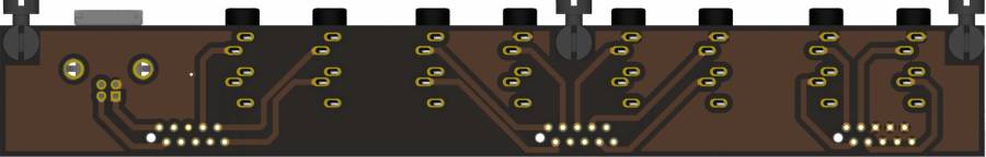

ON this board we have 3 micromatch Connectors, which are crimped fast on a cable
On the other side of the cable you have to solder directly to the Base-PCB,

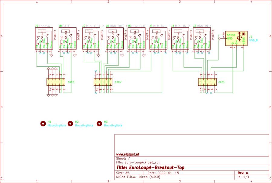

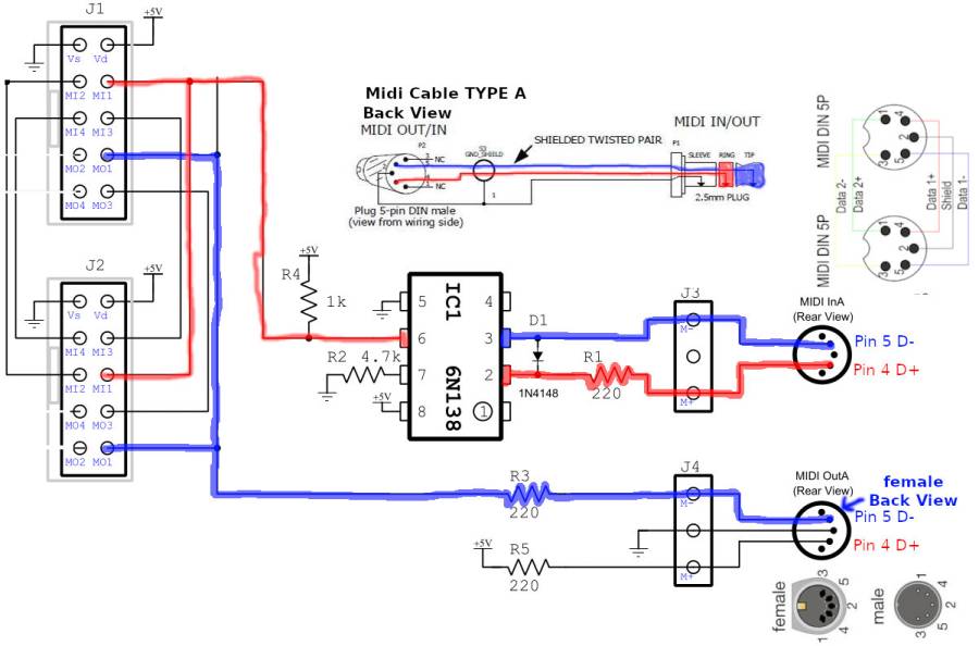

be carefull while soldering - and follow the shematic, which is layout for 3.5 Jack Midi Type B!
Schematic
All necessery Information is printet on the PCB, but also check the Shematic…

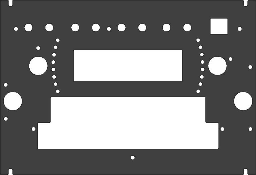

I made a DXF File which you can send to: (once the prototypestate is gone)
Formulor in Germany - Acrylic … 2Pieces incl shipping 42€
frontpanels.de in germany my choose
The Beast - UK
Schaeffer-ag.de
Recommend Material
2mm x 128.5 x 188.58 Aluminium, anodised
contact frontpanels: info@frontpanels.de
frontpanels-euroloopa.zip - NOT TESTET - REVERSE ENGENEERING!!!!!!
