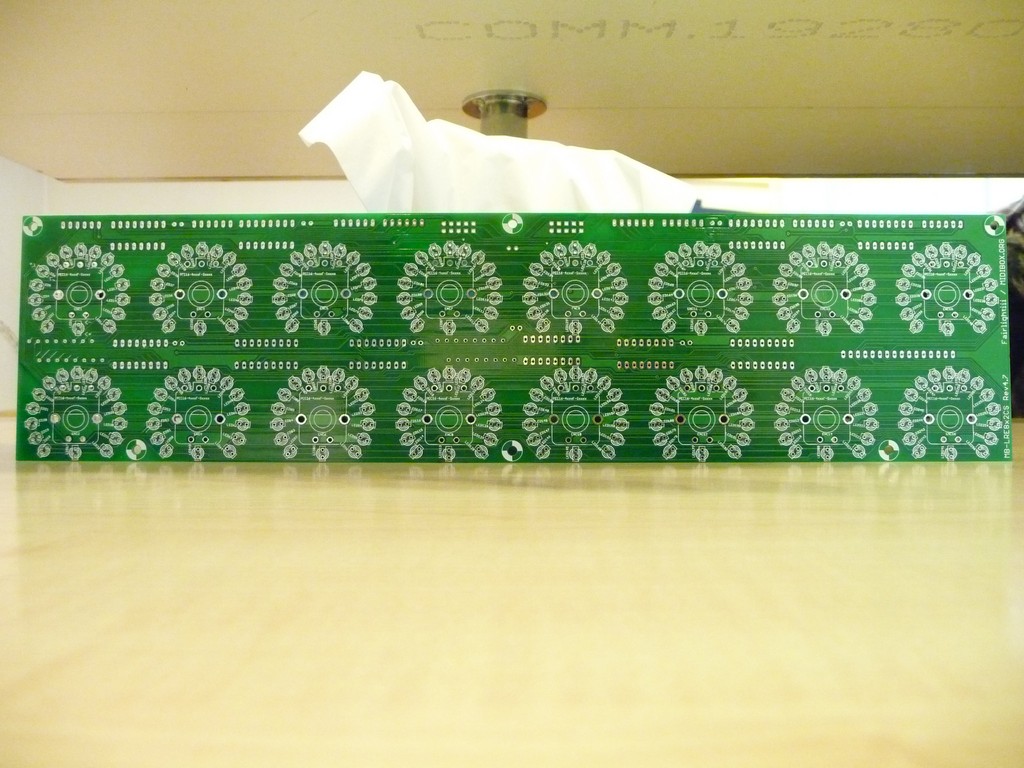

Welcome to the wiki page of the control surface board featuring:
The last revision of the PCB is rev 4.6.
It is a very practical and cheap way to make a midi controller with adding only a core or make a more important controller without having to wire LEDrings.
The PCB have components soldered on the two sides.
Top side: Encoders and LEDs.
Back side: All others components (see BOM below).
The board is 3,335 x 13,452 inch (341,7 x 85,1 mm): slightly less than 2U standard.
The previous revision (2.5) was 3,368 x 13,472 inch (342,2 x 85,5 mm).
The (external) diameter of each LEDring is 34 mm with the use of 3mm LED.
To comply to the footprint of 2x5x7mm rectangular LEDs, the diameter (from the centers of the LEDs -except the lowest one) of the LEDring is now slightly less than 31mm instead of 30mm.
The pitch between each controller remains the same as in the previous version (1,684 inch).
All measurements are given in mils unless otherwise indicated.
1 mil = 0,001 inch = 0,0254 mm. You can use this converter utility.
You can download a better definition version (without ground surfaces for better visibility) here.
You can download a better definition version here.
The origin (0;0) is the bottom left corner of the board.
Note: Be very careful if you use vectorial software (to draw your front panel e.g.) because usually it takes as origin of each part the left corner of the part and not the center of the part !!!
You can take also a look at the *.SVG section below.
You will find the coordinates of LEDs/Encoders in this files.
You will note that the encoders are upside-down because to win some space inside the LEDring. Because they are endless, the use of them is not impacted.
