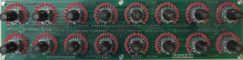

MotionSeQuencer for ControlChanges
for 2xLRE8x2 Boards
for 1x LRE5-LCD2 Boards
