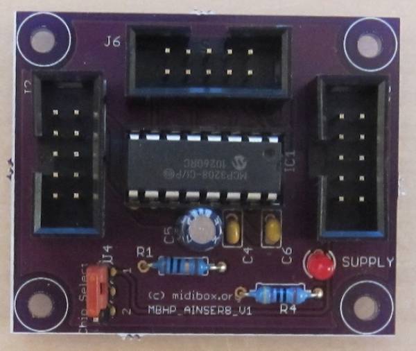

MBHP_AINSER8 is a Reduced version of the MBHP_AINSER64 module without 1-to-8 multiplexers and on-board VR, and only supported by MIOS32!
It is based on the 8-channel ADC MCP3208 from Microchip. It can be used to scan pots and/or faders with 12bit resolution between 0 and 5V.
The accuracy and especially the signal/noise ratio is much better compared to the internal ADCs of STM32 for insignificantly higher costs (around 3 EUR).
Another advantage is the Improved Scalability. While with the previous MBHP_AIN module the maximum number of scannable inputs was limited by the number of on-chip ADC channels, the new approach allows to access multiple MBHP_AINSER64 and MBHP_AINSER8 modules from the same microcontroller.
The ADC is accessed via SPI (e.g. J19 of the MBHP_CORE_STM32F4 module).
Multiple MBHP_AINSER8 (or MBHP_AINSER64) modules are connected to J19 in parallel, and accessed by strobing dedicated chip select lines. J19 provides two chip selects (called “RC1” and “RC2”), if more modules should be scanned, common IO pins could be used for the same purpose (e.g. available at J5). Alternatively, AINSER* modules could be chained, or a 3-to-8 MUX could be used for accessing 8 modules via 3 IO pins of the microcontroller.
