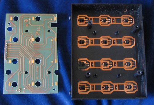

After throwing everything out, I examined the keyboard to find out how to use it.
Under the control board there is a simple 4×3 button matrix (without diodes - but that's no problem, it won't be necessary to press more than one button at the same time).
Because the contacts for the # and * buttons were not connected, I had to solder a few thin wires and I rewired the connector:

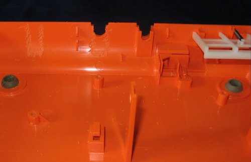

First, I milled away most of the mounting posts in the phone:
