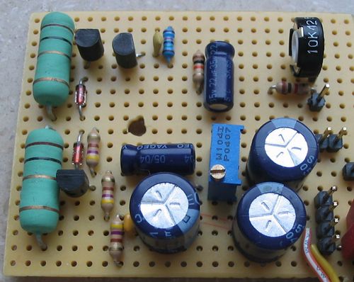

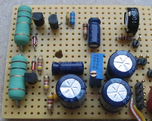

I found out that it´s a bit difficult to use the built-in vocoder bypass. The debouncing of the buttons is not very good on the alesis, so it happens quite often that you switch the bypass on and off again with one button press. When used “the normal way”, this is no big problem because you check the bypass LED anyway. But triggering this button from the core module it could happen that the pickup and the bypass state get “asynchronous”. Checking the LED state from the core is complicated, too. The LED is part of a matrix so there´s no simple way to measure on and off.
So I decided to do it in the analogue domain by using a 4053 chip. This is a 3x SPDT (dual throw) chip for analogue signals, similar to the 1×8 chip 4051 used in the MBHP AIN module. One problem with this chip is that it doesn´t work with +/-12 V. The standard 74hc4053 (e.g. from TI) takes only 5V but I happened to have left over a few max4053 ICs from Maxim from my last sample order. They have better specs and can take +/- 8V supply. So I ordered a pair of 78l08/79l08 regulators and built a little +/- 8V supply for the max4053. You can see it in the next photo on the left side. The original pickup switch applies 5V or ground to two of the control pins so that the 4053 switches between vocoder and direct synth out (this is the yellow and purple wires on the outboard). The bypass works quite well with only a very silent cracking sound (when switching).
the speaker
I thought it would be nice and trashy if the phone could make sound on its own, so I searched for a simple amplifier cirquit. I found this one (german page). It delivers enough power to drive a small speaker. At the moment, I´m using a little PC beeper speaker that sounds really trashy, but there´s a bit more room above the vocoder (behind the grill on the panel), so I will order a larger speaker soon. The speaker is of cause deactivated when a cable is plugged into the audio out. Here´s the amp:
and the whole amp/bypass board in its current state:
everything connected:
To be continued 8-)
