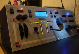

Arkade is a MIDI controller that embeds pairs of everything :
- A pair of analog joysticks coming from a canibalized PS2 gamepad . They center when you release them (+ they're rock solid !)
- A pair of standard analog joysticks (positions doesn't change when released)
- A pair of infra-red distance sensors, a pair of ribbon controllers
- A pair of wheels (modulation, bend) coming from my died DX7s
- A pair of knobs
- Midi In / Out + sustain / expression / switch pedal

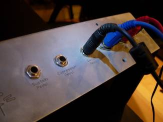

<box 350px right round>
Sustain, expression, and switch pedal inputs; MIDI In/Out, power
</box>
The ideas I had at the beginnig of designing the Arkade were :
- Unusual sensor types (sliders forbidden - knobs tolerated )
- May complement (and be placed over) a poor master keyboard (mod & pitch wheels, ribbons, expression pedal input)
- Set different parameters for each sensor, and save the whole as a patch (in a “touch to select controller” manner)
- Load/save many patches (128 positions at this time) to control either a VSTi, hardware, visuals, whatever
- Able to send program changes and even note on/off easily
- Two persons may play it live (2nd pair of joysticks) without bothering each other
- … anything that cood be missing on any midi controler, like a simple MIDI-gating button (labeled “Freeze/Cut” on the Arkade). By gating I mean : momentary set the level of any controller to zero while you hold the gate button pressed, and back to normal when you release it. Well, you have buttons on many MIDI surfaces out there but they never gate the output of another controler; they just transmit their own value and you have to program the gating by yourself - quite hard (not to say “impossible”) in most cases. On the Arkade, the gate button just … gates, whichever sensor you're touching !
