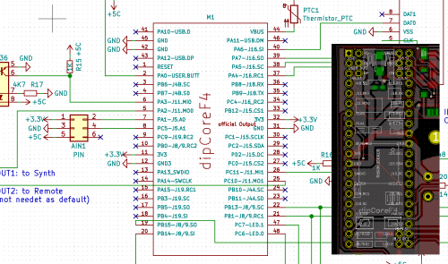

Midibox:
- dipcoref4 - this is the µC Brain for the Looper
- cc-looper - this is the UI-PCB of the Looper
- no other PCBs needet
- µSD-Card, formated with FAT32
- Soldering Iron - with a Dip that can Handle SMD-Parts, Wires, solder Paste for the µC….
- USB Power Supply with µUSB-Connector

BOM
| Ref | Qty | Value | Footprint | MouserPart | |
| C1 – C7 | 7 | 100nF | 0603 Capacitor | 81-GRM33C71C104ME14D | Mouser |
| Rec–1 – Rec—4, UI–5 UI—4, led1, -1 -2 -3 -4 | 11 | REC, LED, beat, CC-IN, | 0603 LED | 630-ASMT-RR45-AQ902 | Mouser |
| 1-16 (LED-BAR) | 64 | bar | 0603 LED | 755-SMLEN3WBC8W1 | Mouser |
| D64 D65 | 2 | 1N-4148 | 1206 Diode | 833-1N4148W-TP | Mouser |
| PTC1 | 1 | Thermistor_PTC | 1206 Resistor | 576-1206L150THWR | Mouser |
| R1, R2, R19 – R34 | 18 | 10K | 1206 Resistor | 603-AC0603FR-0710KL | Mouser |
| R3 R5 R6 R7 R8 | 5 | 47 | 1206 Resistor | 603-RC0603FR-0747RL | Mouser |
| R9-R14, R36, R37 | 8 | 220 | 1206 Resistor | 603-RC0603FR-07220RL | Mouser |
| R15 R16 | 2 | 1K | 1206 Resistor | 603-RC0603JR-071KL | Mouser |
| R17 R18 | 2 | 4K7 | 1206 Resistor | 603-RC0603FR-074K7L | Mouser |
| OUT1 | 1 | Midi | DIN-8-SDF-80J | 490-SDF-80J | Mouser |
| M1 | 1 | DIPCORE32_CMPNT_48P | 517-929870-01-20-RA | DIP-40 | Mouser |
| S8 | 1 | Shift | DT6 | 611-D6R00F1LFS | Mouser |
| S1 – S4 | 1 | Part1 | 611-SERWHAUOA | DTL2-1-LED | Mouser |
| S5 – S7, S9 – S10 | 6 | X,C,V,Len,Pre,Tac | 611-SERRDAUOA | DTL2-1-NO-LED | Mouser |
| ENC1 | 1 | ENC_BOURNS_PEC11 | ENC_BOURNS_PEC11+SW | 652-PEC11R-4215F-S24 | Mouser |
| IN1 IN2 | 2 | Midi | Midi-Socket-MAB5SH-DIN-5 | 566-MAB5SH | Mouser |
| Foot1 | 1 | Pin | |||
| J2 | 1 | BootLoad | |||
| AIN1 | 1 | PIN | |||
| U1 U2 | 2 | 6N136 | SMDIP-8_W11.48mm | 782-6N136-X009 | Mouser |
| -595 | 3 | 74HC595 | SO-16-N | 621-74AHC595S16-13 | Mouser |
| U3 U4 | 2 | 74LS165 | SO-16-N | 595-SN74LS165ADR | Mouser |
| M2 | 1 | µSD_DM3ATDM3AT | ΜSD_DM3AT | 798-DM3AT-SF-PEJM5 | Mouser |
