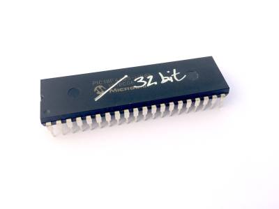

- Board pinout and package compatible with a MIOS8 PIC

- Your favorite Core is now a current component easy to integrate.

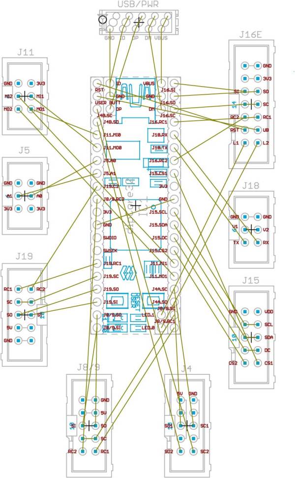

All commons MIOS32 ports are available except:
- General purpose J10x ports were removed.
- LCD port was reduced to a serial one, no more pins J15.D0-D7
- 2 UART only(2 MIDI In/2Out).
- 2 AIN channels only(e.g. pedal inputs)
Check the dipBoard for more details

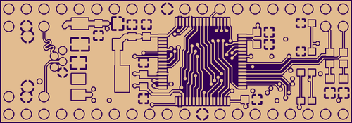

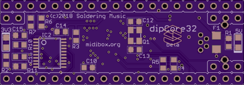

PCB
Pinout
