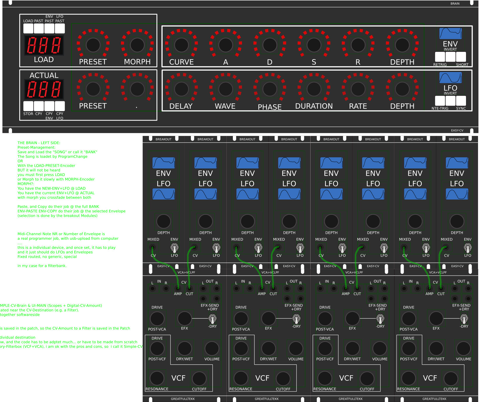

A Breakoutmodule for each CV-Output, with Depth-rotary, Focusswitch (Pushrotary), 2x Scopes (LFO+ENV) and LFO/ENV-Switch to show on one Display the Mixed Waveform & to switch the Rotary to “ENV” or “LFO” Mode (there is only space for one Encoder - maybe just make PAN Style, instead of 2 individual level -maybe more live feel?, how ever when using an 3Stage switch, i could disable MIX-View, or display it on ENV or LFO…maybe a good choise ;) ) The Depth-rotary has no Ledring, want to display it as a bar or as Value in the scope…

FrontPanel
Brain
THE LEFT SIDE of the BRAIN > Preset-Management:
Save & Load the PROGRAM, can be done by Midi-ProgramChange -or With the LOAD-PRESET-Encoder
then press LOAD -or Morph to the next Program slowly with the MORPH-Encoder
-Another option is to take a PUSH-ENCODER for LOAD & STORE > and load and store it by pushing it… would free 2 buttons for other functions.
MORPH?:
-The Upper 7 Segment LED- Display: is the LOAD Display indicate the new Program with ENV+LFO
-The downer7 Segment LED- Dsipaly: is the STORE Display it indicates also the current Program with ENV+LFO
–with morph you crossfade between both Presets (be carefull, first Store the current Preset
Paste & Copy do their job @ the whole PROGRAM Memory
ENV-PASTE & ENV-COPY do their job @ the selected Envelope > (ENV-Voice selection is done by the breakout Modules) … LFO..same
Midi-Channel Note NR or Number of Envelope is a real programmer job (C), with usb-upload from computer
…. this is a individual device, and once set, it has to play > and it just should do LFOs and Envelopes
Fixed routed, no generic, special > in my case for a filterbank.
THE RIGHT SIDE of the BRAIN > LFO + ENV Settings (one Voice):
ADSR with:
CURVE Paremter which give exponentially to it (no straight lines While Fall and Rise)
Short: just shorten the Maximal lenght of a Envelope, haveing more Feeling on Encoders
should change Scope Display also…
LFO: get synced with Midi, and there is a retrigger by Notes…
Phase: offsets the start-Phase
Delay: simple delay (nte-Trig)
Rate: clear from 8 wholes to 128th or so
Wave: access to the Waveforms
Duration: interpret Midisync in trippled, whole notes or whatever…
DEPTH: is the maximal Value of FALL and RISE and SUSTAIN, i know i loose resolution with this…but i have to have a memory filterbank,…doing depth instead with Potentiometers on Filtermodules… would give no memory…
BreakOut
1. Discharged UserInterface for the Brain in “Island mode” (Scopes + Digital-CV-Amount)
2. CV-Breakout EuroModule to be located near the CV-Destination (example: a Filter).
2 Waveforms (ENV+LFO) are mixed together softwareside
that bring 2 advanteges:
1.save one CV-Output
2. the Amplitude of each Waveform is saved in the patch, so the CV-Amount to a Filter is saved in the Patch
That bring 2 disadvanteges:
1.LFO or ENV cant get patched to individual destination
2.the Resulution gets lower 2 very low, and the code has to be adptet much… or have to be made from scratch
Because I use the device for a Memory-Filterbox (VCF+VCA), i am ok with the pros and cons, so i call it EASY-CV
Envelope Scope: show the ENV-Waveform
or the Mixed-CV-Output-Waveform (when Switch is in LFO Mode)
and show the Envelope-Amount with a BAR or as numeric Value?
MIXED CV Plug: CV-Output > Mixed Waveform ENV+LFO
Switch @ ENV:
- Depth-Encoder change ENV Amount of the CV-MIX
- ENV Scope will show ENV Wave
- LFO Scope will Show CV-Mix
Switch @ LFO: visa versa ENV
Press the Encoders built in ENCODER-BUTTON:
will switch the BRAIN-A-D-S-R and L-F-O ENCODER to the Page for THIS Module…
workflow, see what you have with a Scope, over a filter, and edit exact this selected CV on the brain in full detail…

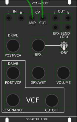

VCA-VCF
CVś(AOUT):
1.VCF-CUT
2.VCF-RES
3.FILTER DRIVE
4.VCA-ENV
5.VCA-DRIVE
6.DRY-WET (Orginal vs Filtered Mixer) 7.Send 2 EFX1 8.Send 2 EFX2 So 1x 8AOUT-Module for each “Channelstrip”, makes a total of 4x8AOUT-Modules. The Module of Choise is a 16Bit, since i control with the the same AOUT-Channel ENV+CUT-OFF… so there is no analog potentiometer for Cutoff or resonance… it is all saved in the Preset.

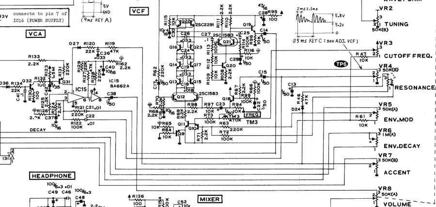

Original Schematics 303 - VCA-VCF

need special 4gang 50KB potentiometers for a STEREO Resonance (stereo filter, one UI)
need special 4gang xxKB (50?) potis for a Stereo DRY/WET Mix
need special 2gang xxKB (50?) potis for EFX Send Mix Stereo
need special 2gang 50KA potis for CUT-OFF Stereo
need special 2gang Post Transformator Potentiometer (Value have to look in my prototype which is used)
