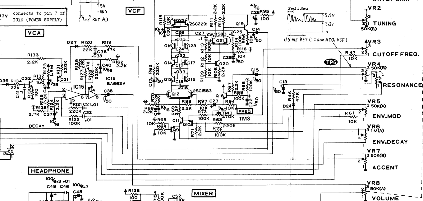

The Module of Choise is a 16Bit, since i control with the the same AOUT-Channel ENV+CUT-OFF…
so there is no analog potentiometer for Cutoff or resonance… it is all saved in the Preset.
the VCA is basicly a simple VCA (MS20Like) or something
the VCF are a 303 18dB for the 24db Filter it will be a SSM2044, where bords are available.
Original Schematics 303 - VCA-VCF
In order to not use those overprized MATCHED-PAIR-TRANSISTORS (over 2€ on the cheapest place) i have to use standart Transistors and make a VBE-MATCH on my own, i have already a PCB from here - to measure the transistors with a Multimeter:
https://midisizer.com/other/vbe-matching/
