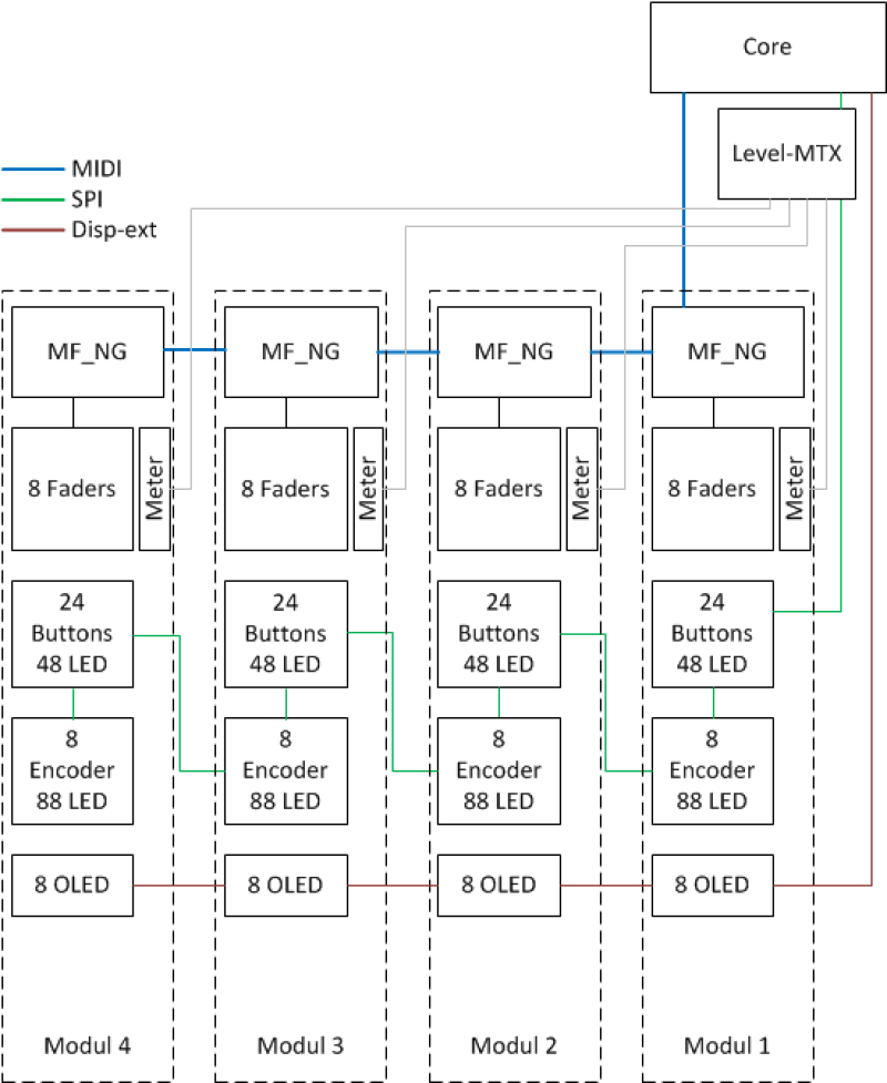

The goal of Fadercore is to make a Modul of 8 Faderstrips where every strip has 1 Oled, 3 Buttons and one Encoder and is scaleable up to 32 Faders (4 Modules)
The Heart of a Fadercore is a STM32F4Demo or a LPC17Core with a special Header for Display chains…
The follwoing steps are to do:
Make a board that has connections to 32 displays. - done
Make a board that has connections to 8 Encoders with LED rings. - done
Make a Faderboard that connects 8 Motorized Faders to the Core board. - done but has to be redone for STM32F4Demo
Make a board that connects to 24 Buttons and min. 48LEDs if not (RGB) 72LEDs.
Make a Frontpanel. - depends on Buttonboard…
Make a Case that is scaleable so it is Possible to rise the number of Fadermodules…
Make a Demosoftware .NGC file that can be used from Midibox newbies…
Make a Board that holds the Matrix for small meters.
