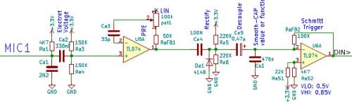

Konga > Mic > Preamp > Schmitt Trigger > uController + KeyboardNotes Input = Drum Triggerd Notes

Schmitt-Trigger:
- TS-274 OP-Amp
- 14 Pin - DIP-Socket
- Pin-Header 2x5Pins (to connect the PCB to Core J5A)(you will also need a cable 4 that)
- Resistor R1 22K
- Resistor R2 4K7
- Resistor RFB 100K
- Resistor for Output-Gain-Reduction 100K
- 2x Electrolyt Capacitor 0,67uF (to decouple audio in and out)
- Electrolyt Capacitor 10uF for Supply
- Capacitor 100nF to denoise the OP-Amps-Rails…
- 2 Audio Cables+Sockets for the connection to the Recorder (6,3 mono jacks)
