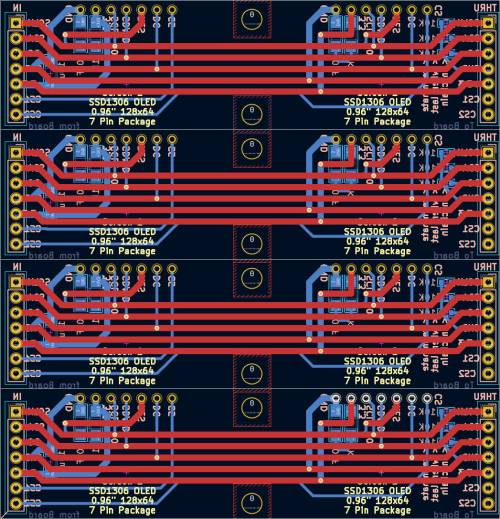

LRE8x2 096 SSD1306-BAR for Eurorack V2
I made this PCBs to use it with Fairlightii´s mb-lre8x2cs_pcb
PCB
I didnt panalize it, so you have to do this when ordering the PCB online
you will need 4 PCBs per LRE8x2… normally you want to order 8 PCBs (using 2x LRE8x2)

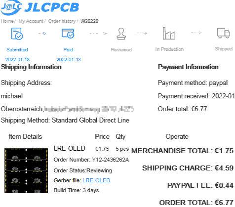

Here are the gerberfiles for production - i made it withJLCPCB
lre-oled-bar2-gerber.zip
