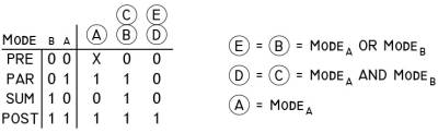

All others 5 switches are for Mode purpose.
5 is too much lines, remember I've got only 4 modes then I may reduce it to 2bits, 2 coding lines.
I connected the Switches to get this:
As you can see E=B and D=C then it's reduced to 3 lines.
Now I add my 2 required inputs lines, ModeA and ModeB
We can extract that:
It's ok, I need 1x OR gate and 1x AND gate, on PCB I use 2 small 74HC1G32 and 74HC1G08.
And finally I obtain to control everything with 4 lines:
- 1 logic line for Bypassing, Active at High.
- 1 logic line for 2P/4P switching, 4P at Low, 2P at High.
- 2 logic lines to code the 4 Configuration Modes.
