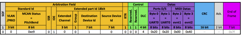

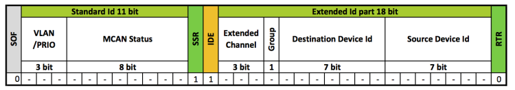

The arbitration field has two possible formats, i.e., two sizes:
- The Standard ID format (CAN 2.0A & CAN 2.0B), which supports 11-bit identifiers.
- The Extended ID format (CAN2.0B only) which supports 29-bit identifiers, with the eleven most important bits common to those of the Standard format.

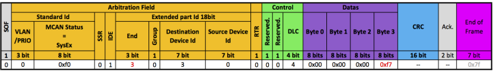

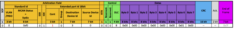

Two examples of Extended (29bit) ID.
We can mix both formats on the same buss without any trouble.
There's a bit in the control field of the packet that indicates the format named “IDE.” Standard=0, Extended=1.
In a 29 bit ID this IDE bit is part of the arbitration and causes a standard ID to gain priority over an Extended one (0 always wins).
Because of this feature there's also two sizes of filter available.
Additional RTR and SSR bits for message type.
- The RTR bit, indicates the type of message: (0) for data message, (1) for request message.
 - The additional SSR bit (Extended ID only), is for message type too, whereby the position in the frame allows it to take priority over the IDE bit if necessary.
This bits are part of the arbitration but not part of the ID; they are control bits.

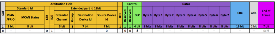

The control field
Here we will specify the type of format, type of message and data length.
- The IDE bit, (0) ID is Standard(11bit), (1) Id is Extended(29bit).
 - The 4 DLC bits, this is the Data Length Code(from 0 to 8).
The data field
This the data area, 0-8 bytes wide; length is indicated by DLC.

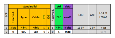

A more detailed Standard frame.
Upon a received packet, the number of bytes must match DLC to avoid a CRC error.

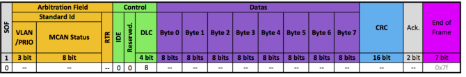

MCAN specifics: frame (packet) format
⇒ frame format will also have a new composition!
ToDo…
We use the different frame format (length) depending on the MIDI message type.
This will optimise traffic on the buss.
Default vlan_prio = 0.
A MCAN Standard frame.
 A MCAN Extended frame.

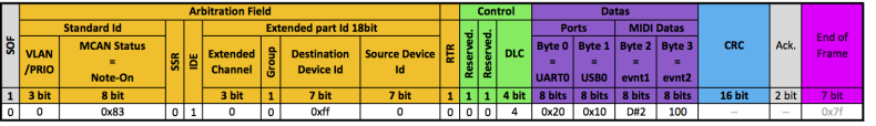

Voice messages
- Note-on, note-off … pitchbend events are 'unicast' on the buss. We need the device ID and the Extended channel.
 - There is data, where the data length depends on the exact type.
 - We need to insert the source and destination ports. They can be USB0 to SPIM7 and the other MCAN buss if it's available.
 - An Extended ID is required for this type of message.
e.g. Note-On:
 Note: D#2, vel: 100 on Ch: 4, from USB0 of Device Id#0 to all Devices UART0 Port(Broadcast).

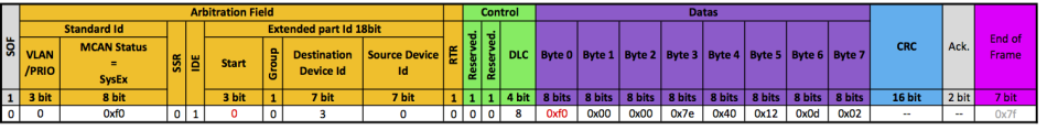

SysEx messages
- System Exclusive messages are 'unicast' on the buss. We need the Node ID.
 - The Extended channel field is use to know which part of the stream was received (0)start, (1)cont, (2)start+end single packet, (3)end.
 - There is data, the stream is divided in 8 byte packets. Last packet has a variable length depending on the remaining bytes.
 - We do not need to insert source and destination ports, the stream contains the MIDI Device ID to target.
 - Multiple Extended packets are required for this type of message.
e.g. A MCAN 20 byte SysEx stream:
First packet(start).
Second packet(cont).
 Last packet contains 4 bytes.
A 1024 byte stream takes 330ms over a regular MIDI, the same stream takes 8,5ms over MCAN.
