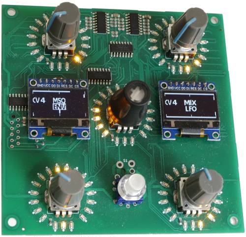

Synth-Patch-Editor & Motion-Sequencer 4 ControlChange (= CC-Automation)
Introduction
Controls and automate a Nord Drum2 (Drum-Synth )NORD DRUM 2

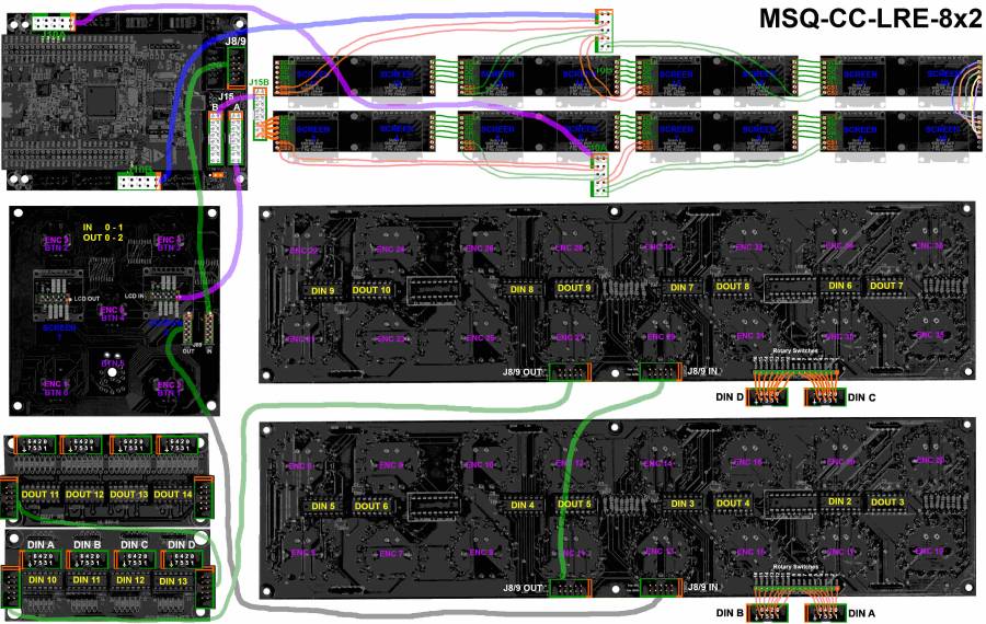

Cabeling Modules

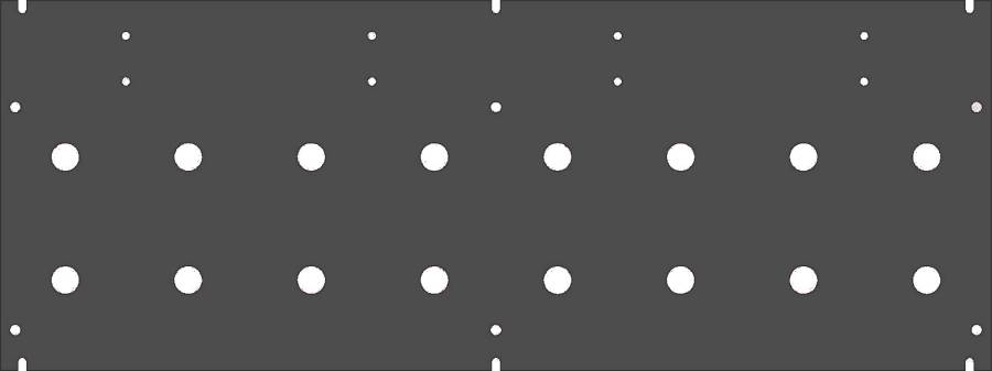

Frontpanels
MBHP
see LRE-OLED-Bar
