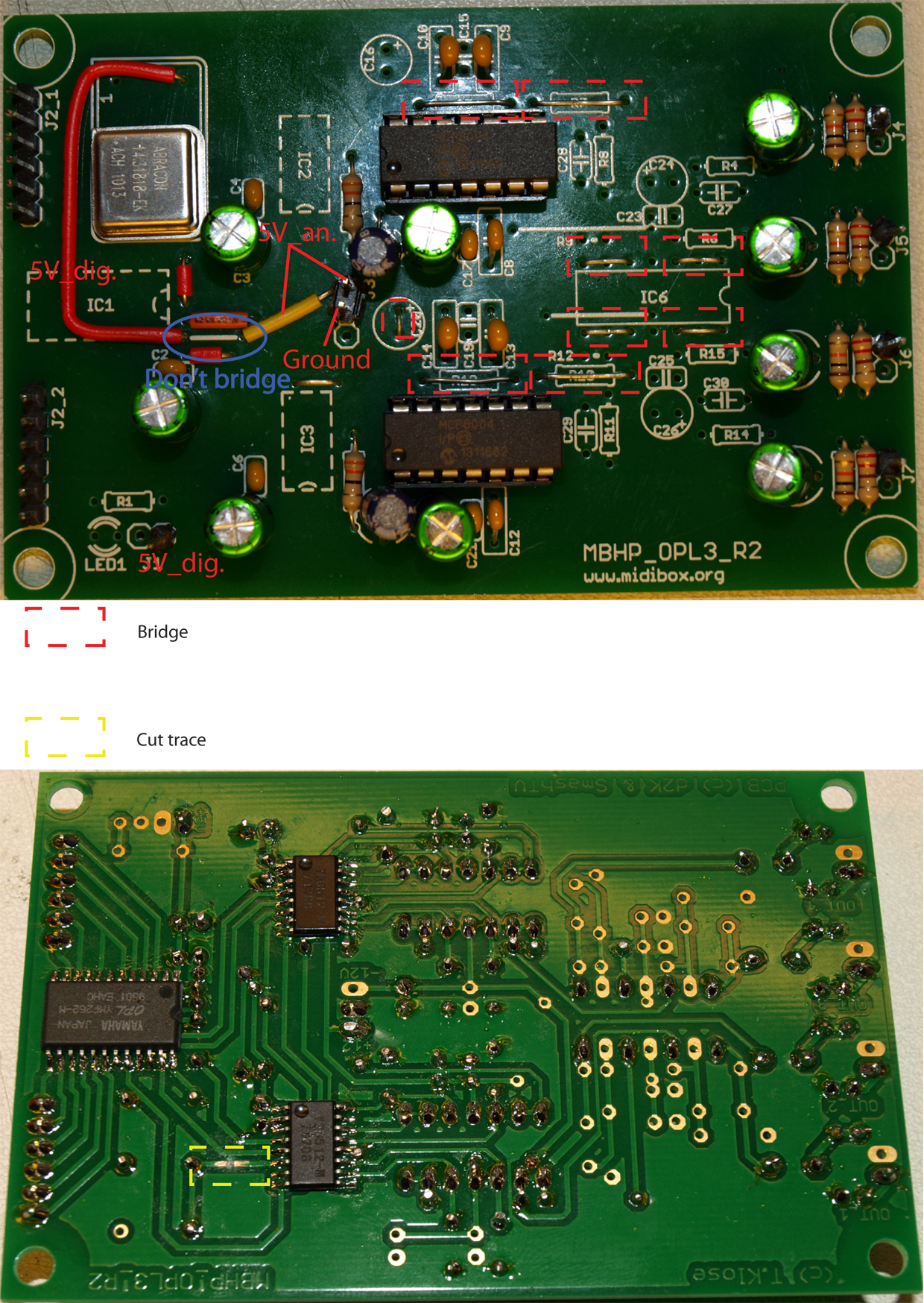

- Replace R5,R7,R10 and R13 with jumpers
- Bridge IC6 pads 1&3, 5&7, 8&10 and 12&14
- Leave out:
IC6
R4, R6, R8, R9, R11, R12, R14, R15
C15, C16, C19, C20, C23-C30
- Bridge C20 pads (to supply Ground for the op-amps)
- Leave out bridges to IC6
- Use MCP6004 for IC3 and IC5
- Supply 5V to the +12V pin, and Ground to Ground
This way the second buffering stage is left out.
In the sammichFM, nILS designed a separate dedicated 5V supply for the DACs (YAC512) and the op-amps.
To modify the OPL3 module for this approach:
- Cut the trace between the 5V pin of the Oscillator and the DAC
- Leave out the middle horizontal bridge from IC1
- Connect the right pad of this bridge to the 5V pin in the middle of the board with a jumper
- Connect the left pad of this bridge to the 5V pin of the Oscillator with a jumper
- Two separate 5V voltage regulators, IN pins connected through a ferrite bead
- One 5V source to Core and J1 of OPL3 module
- The other 5V source to J3 of OPL3 module
- Ground ONLY to J3!
