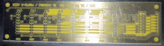

With the following Circuit/PCB you can drive up to 8 of this nice Nokia-3310-LCDisplays on a single Core-Module
Click on the Images to enlarge…

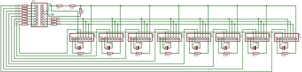

based on this schematics…
