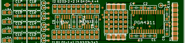

The bare channel board looks like this:

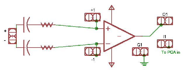

The input section of the channel board looks like this:

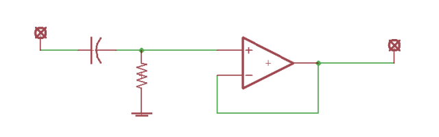

From that you can make a LOT of different input sections. A VERY simple input section would be the Unity gain unbalanced input buffer. It's very simple, and looks like this:
Figuring this out shouldn't be too tough. We follow the input from the “+” input terminal through capacitor C11. We don't need a series resistor here, so we add a wire for the bottom resistor beside C12. We do need a 10K resistor from the + input of the op-amp to ground, so we add it, between the “+1” and “G1” terminals. Then, for the feedback loop, we add a jumper from “O1” to “-1”, finally, we connect “O1” to “I1” to pass the result to the PGA input.

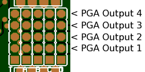

So we have signals buffered and routed into the PGA chip. The four PGA outputs must now be connected to whatever output busses they mix into. Each will need a 10K resistor to ground, and a 10K resistor into buss A,B,C, or D. The board is arranged for SIP resistors, but regular 10K resistors can be used as well. This section of the channel board looks like this:
The square pads at the bottom of each group are, from left to right, Ground, Mix A, Mix B, Mix C and Mix D. So we add a 10K SIP resistor, or 4 separate resistors, from the square pad marked “T” to each of the four holes above it. Now all four outputs are terminated. Then we add a 10K resistor from each of the outputs to whichever buss it mixes into. For a line mixer, the square A pad needs a resistor to output 1 and a resistor to output 3, and square pad B needs 10K resistors to Outputs 2 and 4. If this is a “full” mixer with effects loops, we use 10K resistors to connect A with 1, B with 2, C with 3 and D with 4.
