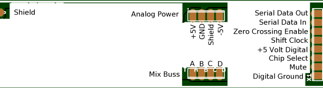

There is another oddity. Note the two top pins in the digital group. “Serial Data In” should connect to the “Serial Data Out” of the board below. This will require a bit of adjusting.
Whatever type of stack pins you are using, insert and solder all eight digital pins. Then turn the board over and cut off the tail of the top pin (Serial Data Out). Gently bend the tail of “Serial Data In” over a bit, so that when you stack this board it will connect to the “Serial Data Out” socket below it. This will have to be done for every channel board in the stack, including the bottom board plugging onto the output board.
