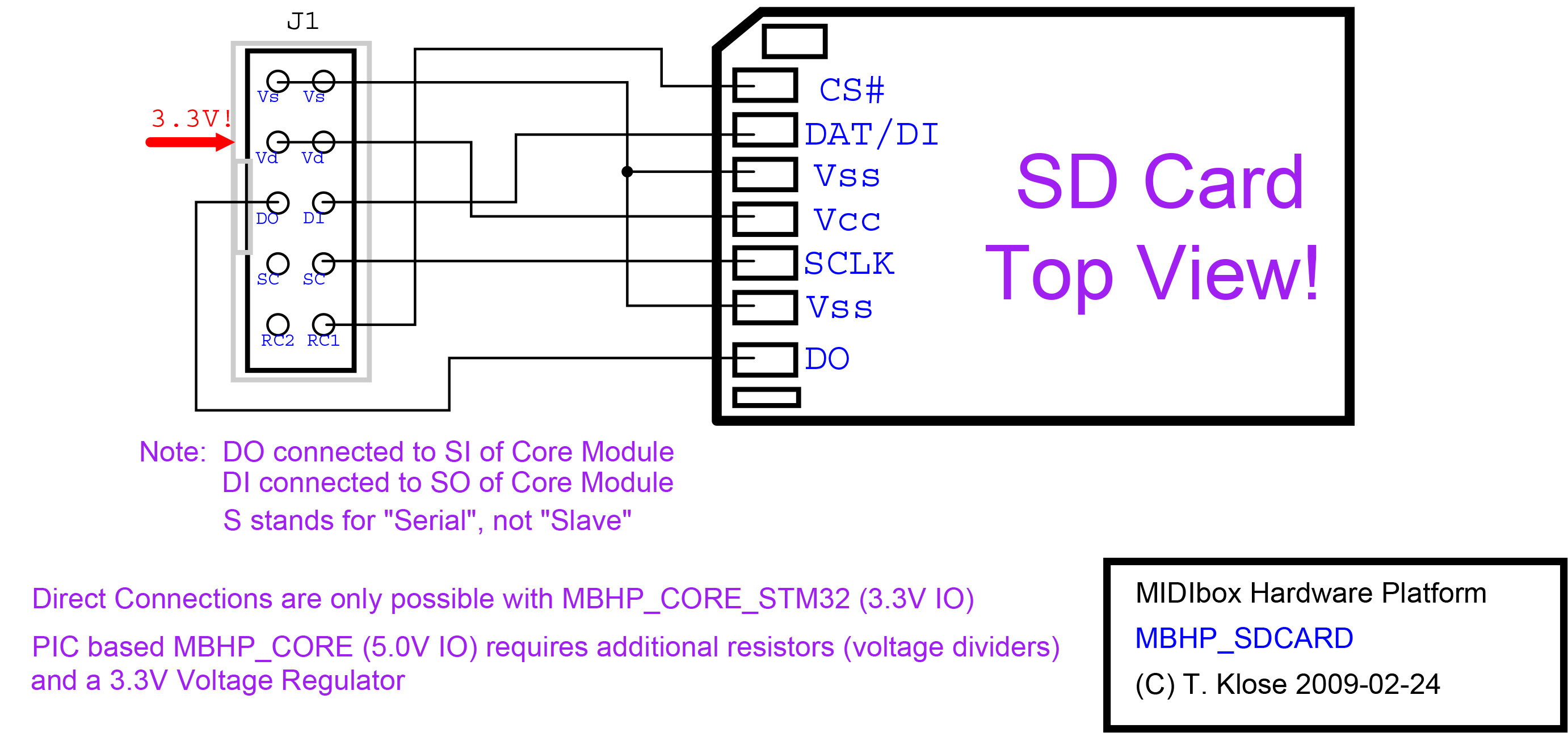

SD Card Could be interfaced with Core board for Data Storage / Reading . It replaces Banksticks.
Interconnection
STM32 Specific
The resistor array R30 of the MBHP_CORE_STM32 module shouldn't be connected when a SD Card is used, because pads are configured in Push-Pull mode at 3.3V. SD Card transfers could work unstable with these Pull-Up resistors!
