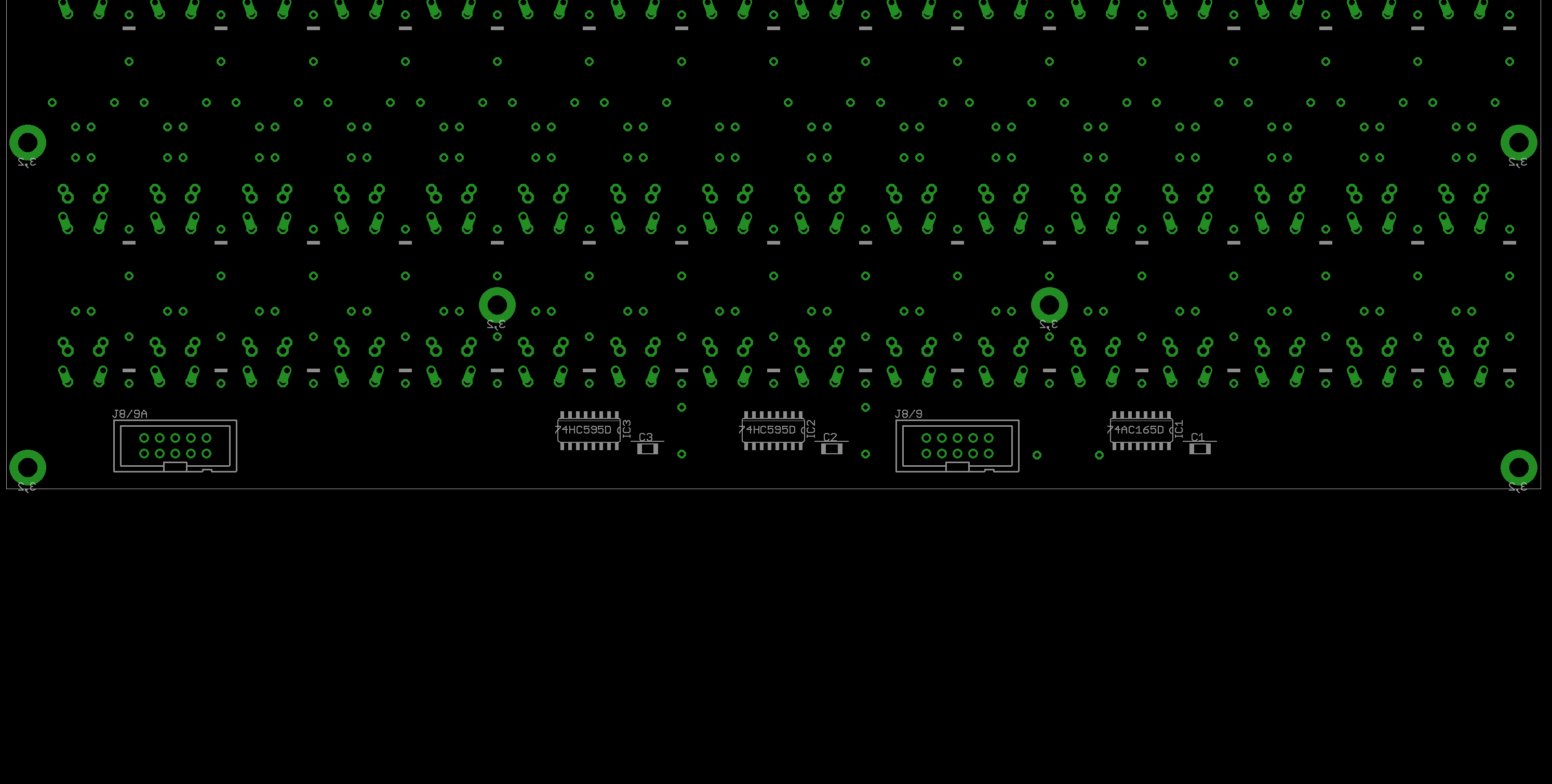

v1.0: first release. Errata: the bottom silkscreen names/values are missing. Please refer to the PCB image. In words, the two 74HC595 chips are next to each other, while the 74HC165 chip is on the right side of J8/9 when viewed from the rear.
PCBs

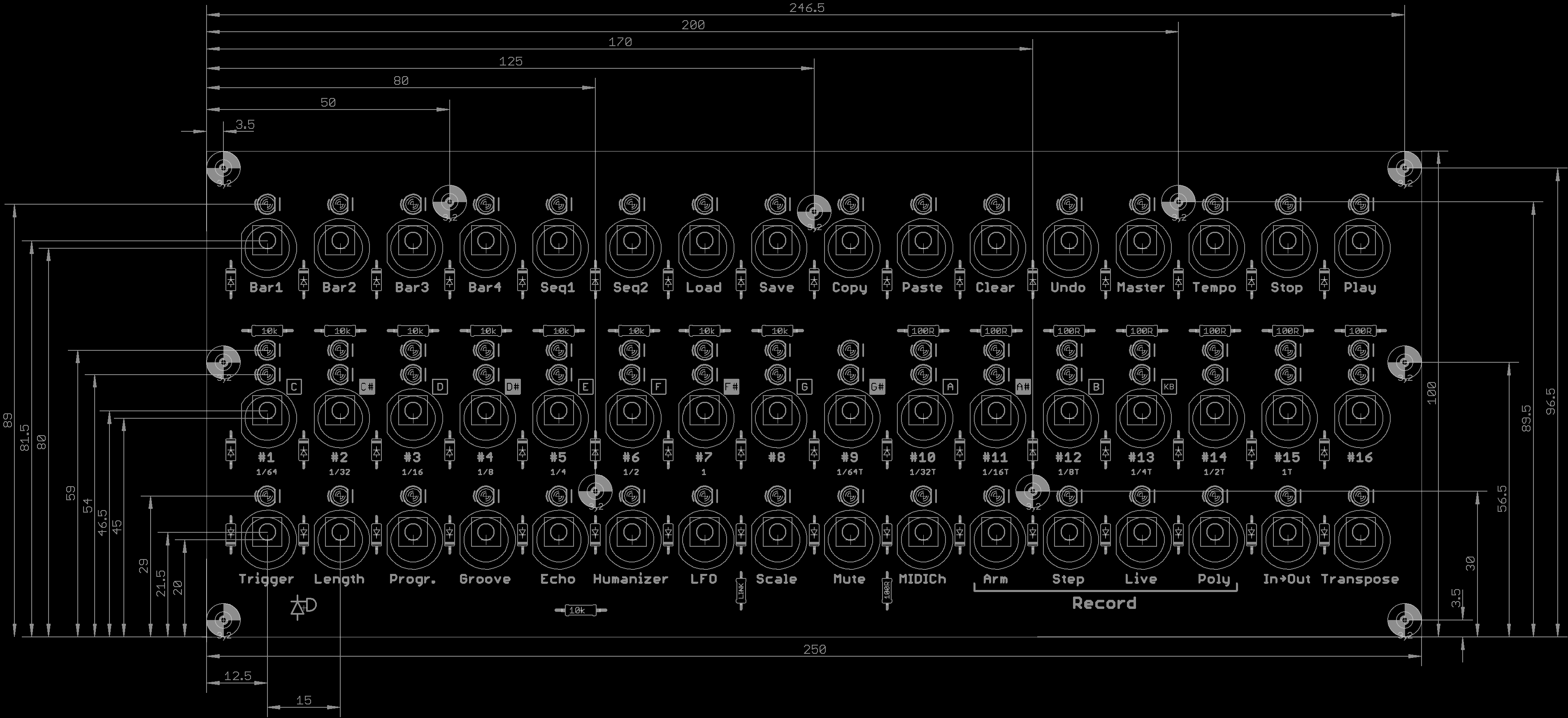

Front + dimensions (in mm) of switches, LEDs and mounting holes (M3)
Rear placement of ICs (ignore the “AC” package, the correct CMOS family is 74HC165)

Putting the board together is simple. As usual, start with the flattest components and work your way up.
SMT Components
- 3* 1206 capacitors
 - 1* 74HC165
 - 2* 74HC595
If you haven't soldered SMT before it's best to start here so you have a flat PCB to work with. A good strategy is to tin one of the (corner) pads with solder, then place the part with tweezers before forming a joint. Before continuing with others, ensure the part is correctly aligned by reflowing the single pad as needed. If it takes many tries, be sure not to overheat ICs. After a while the flux will be less effective at wetting the joint and so extra through a flux pen or similar is nice to have on hand.
It's good practice to visually and electrically check for short circuits between pads and remove excess solder with braid when required.
Resistors (+link), Diodes and Switches
- 9* 10k, left side (refer to PCB image)
 - 8* 100R, right side (refer to PCB image)
 - there's a set of dummy pads if you want the line of resistors to look symmetrical, it's just for show :)
 - 1* LINK
 - 48* 1N4148 diodes. Note carefully the alignment of the cathode band. The top two rows point “north”, while the bottom two point “south.” If you get any of these wrong, the switches will not work.
 - 64* LEDs, cathode marked by the flat part on the silkscreen. As noted, usually you will have 16 red and 48 green or other colour options. If you intend to build an opaque case, you may wish to install them “proud” i.e. only soldered once they're pushed up into the panel. For transparent cases, it's fine to mount them “flush” to the PCB.
 - 48* switches. See part notes above. You can use different colours to help identify the different functions.
Headers
- J8/9 should be mounted on the rear of the board.
 - J8/9A is optional for extending the SRIO chain (e.g. TPD, BLM etc.)
Interconnection to Core
J8/9 connects to J8/9 of a Core module (LPC17 or STM32F4).
