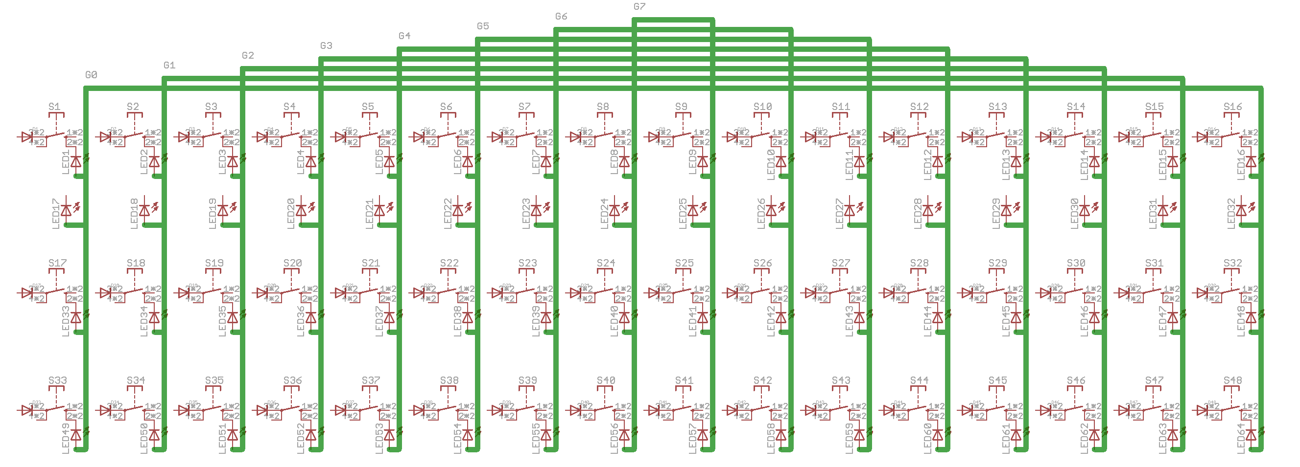

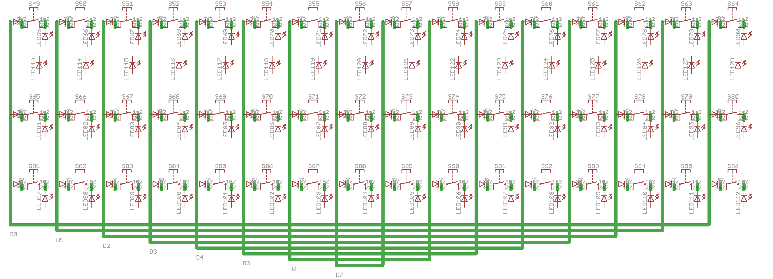

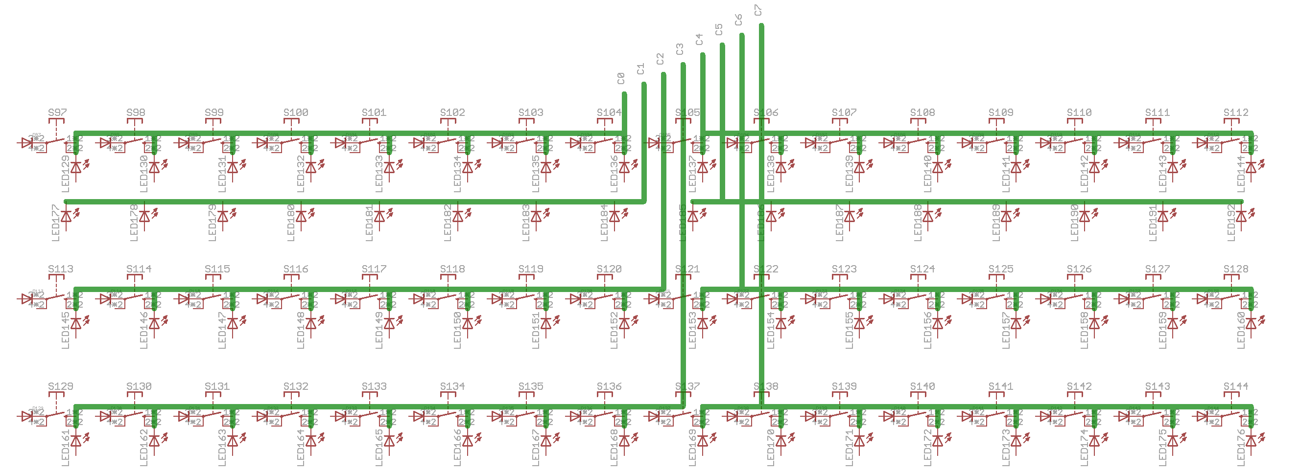

Schematic
Matrix wiring
Wiring follows the same form as the original SEQ v4L. Each element is shown separately (please ignore the part designators):
D0-D7 are used to scan switch input columns
C0-C7 are selection pulses on 8 “rows”
G0-G7 control LED columns

Circuit description
The circuit is merely a single colour 8*8 BLM (button LED matrix) arranged as a 16*4 with one row of switches left out. Normally a different colour LED will be used to indicate steps. A J8/9 connector carries the SRIO chain for 2* 74HC595 and 1* 74HC165 chips (with coupling capacitors). No current sink transistors are used. The remaining components are diodes on every switch to avoid false triggering, pull up resistors for the DIN inputs and current limiting resistors for LEDs.
