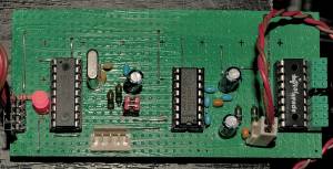

The current board version v1.3 has a lot less backside cabling, is easier to solder, parts have all convenient sizes and the board dimensions are landscape; similar to the MBHP-DIN/DOUT PCBs.
Here is a Picture Gallery v1.3 that shows the process of soldering the breadboard along with some final pictures from different views.
Here is a Picture Gallery v1.0 (for historic reasons only)
Don't cut the legs at once, use them to build the paths at the bottom!
I tried to make the board as small as possible, but there should be enough space to add additional pins if necessary.
