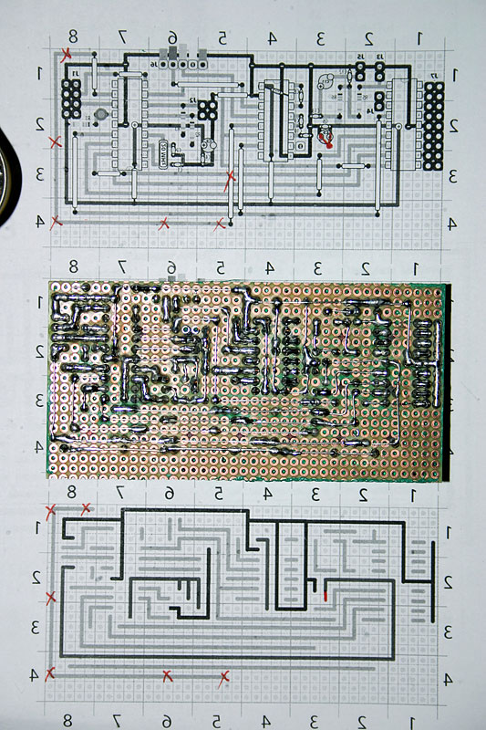

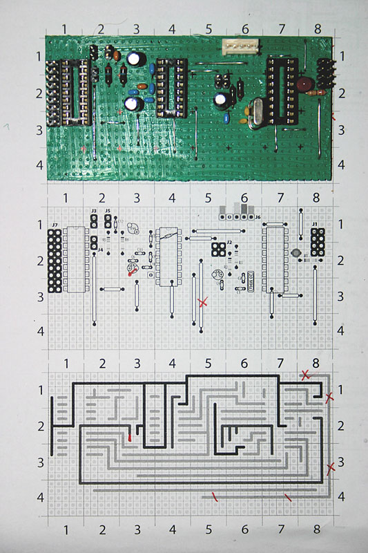

There are currently no etched boards or etching layouts available. But here's a detailed plan for a breadboard. Soldering that shouldn't take longer than soldering a premade one.
Download the PDF plan from below to get started, it contains also a list of needed parts. If you have FreeHand, you should definitely also download the source, because you can switch the visibility of layers. However, the PDF contains multiple views of the Breadboard Construction, so it should be easy to rebuild.

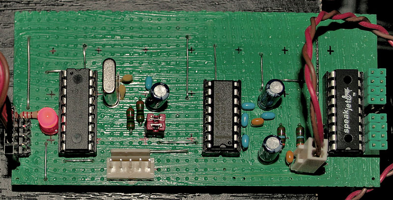

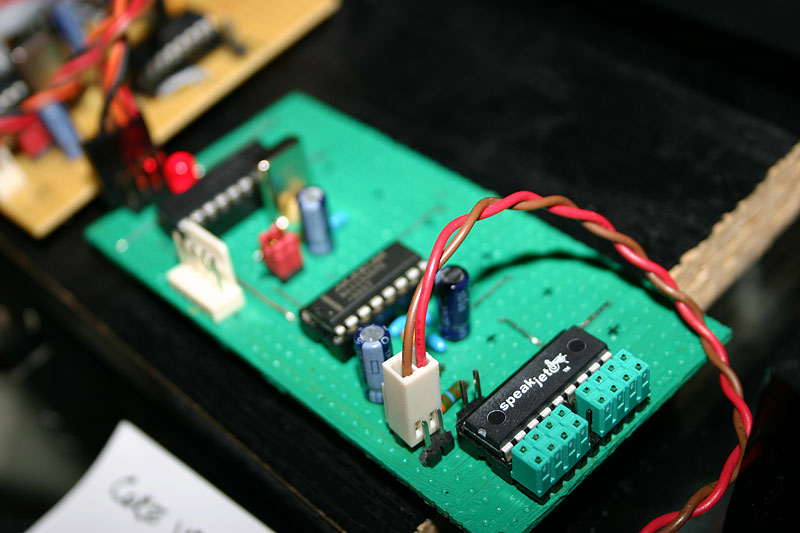

7. Soldering the Board
The current board version v1.3 has a lot less backside cabling, is easier to solder, parts have all convenient sizes and the board dimensions are landscape; similar to the MBHP-DIN/DOUT PCBs.
www.audiocommander.de_picbrowser_galleries_070305_kii_img_7772.jpg www.audiocommander.de_picbrowser_galleries_070305_kii_img_7773.jpg
www.audiocommander.de_picbrowser_galleries_070305_kii_img_7763.jpgwww.audiocommander.de_picbrowser_galleries_070305_kii_img_7766.jpgwww.audiocommander.de_picbrowser_galleries_070305_kii_img_7767.jpgwww.audiocommander.de_picbrowser_galleries_070305_kii_img_7768.jpg
www.audiocommander.de_picbrowser_galleries_070305_kii_img_7760.jpgwww.audiocommander.de_picbrowser_galleries_070305_kii_img_7761.jpgwww.audiocommander.de_picbrowser_galleries_070305_kii_img_7769.jpg

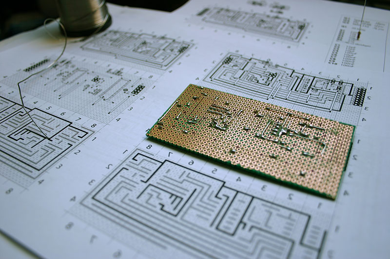

Here is a Picture Gallery v1.3 that shows the process of soldering the breadboard along with some final pictures from different views. Picture Gallery v1.0 (for historic reasons only)
Don't cut the legs at once, use them to build the paths at the bottom!I tried to make the board as small as possible, but there should be enough space to add additional pins if necessary.
