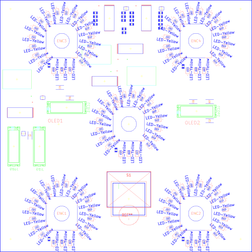

The Design is optimized for Pick and Place > all SMD Parts are on the Top-PCB
The Rest is Thruhole > easy handsolder
now waiting for Presoldered PCBs
