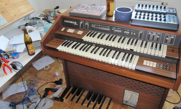

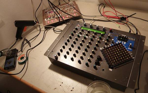

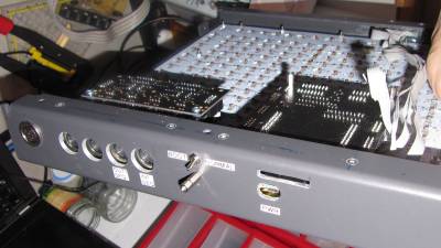

yes there is a 8bit Prototype, built in a Techstar made it a TEKKSTAR, but also there it was soon replaced with a 32Bit Core,
it was a 8×8 LED-Matrix, with 2×8 Buttons, on Breathboard
a other 32bit Variante built in on the other Upper-Manual in Crumar 198, UI-controlled via a BCR2000

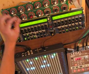

V1: the Matrix has also a Trigger-Sequencer built in, the Melodys have to come from anywhere else, but @ the end, they have to be plugged into the matrix…
Trigger-sequencer, a few facts:
- is a Drum-Step-Sequencer
- 256 Steps in total
- minimal LoopSection is 16steps = 1 Page, there are 16 pages to chain
- intro LoopSection, from step 0 until to the “minimal LoopSection”- is played once, then it loops the normal LoopSection
- The sequencer is made to give a static NoteStream, the Song-Structure is done by the TriggerMatrix
- Full Velocity control, visible with 3 different colours, each colour-Vel is set with its own CC
- Free programmable Swing to each Step, with 2 different swing Length-sets, which are controlled live via CC
- copy, paste, erase of pages
- copy, paste, erase of rows
- forward, backward, fw><bw - play direction
- Not only 4/4 are possible, all other things like 5/4 are possible! +++

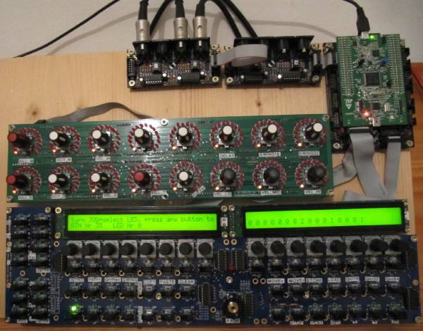

Generic Interface
Generic in sense of: PCBs that already out there:
- SD-Card and some wires (which all are crimpable)
so when you have those things, upload the Code & watch the videos above
Serial Chain is: Wilba SEQ-CS and then LRE8x2
code is working, SEQUENCER timing is a mess, i was still a newbee in c > “learning by doing”

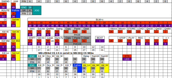

here is a "FrontPanel+Pin-Out" where the functions on the WILBA CS & LRE8x2 are explained

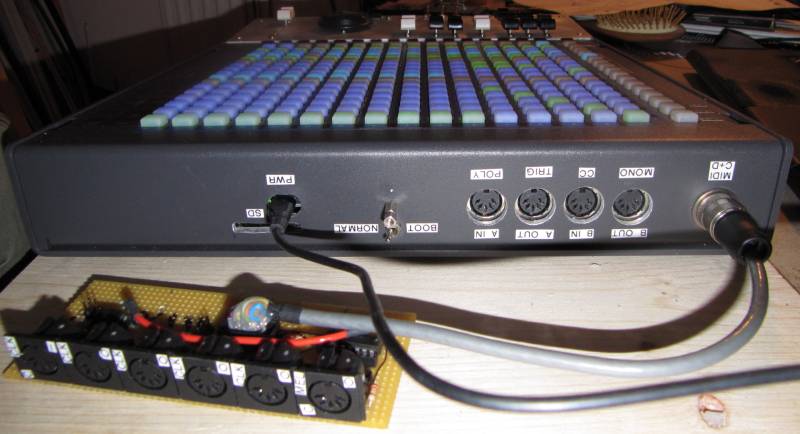

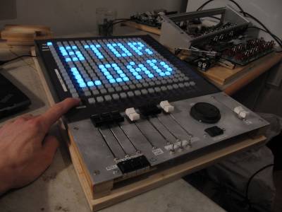

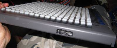

TriggerMatrix V3
Teaser

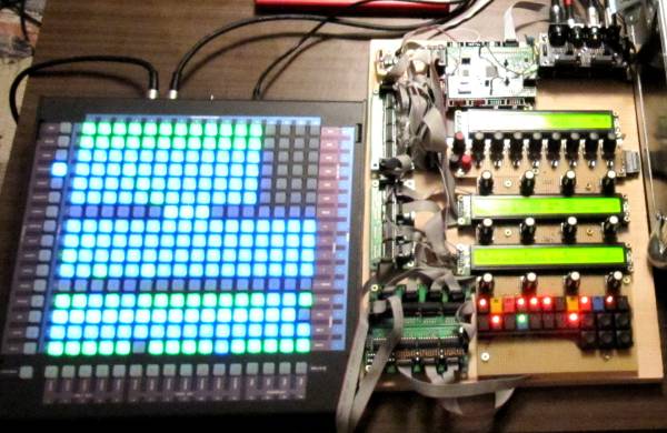

V2 was Song-Structured, V3 is to JAM
in V2 where lot of UI-Elements, Menues, and Settings.
V3 is stripped down and optimized: 8 Faders, 5 Tactial Buttons, 3 Switches, 1 Encoder, + BLM16+16X.
its more the orginal V0 Tekkstar, there we had only a matrix a view buttons and Pots
3/4 4/4 4/5 and other settings are Set on the 16×16 Matrix with “on matrix text”.
The Timing now is rock-steady.
New is the Clip-Launcher, here we can Ableton-Style switch Clip-Variations and Songs
Now we have a Roll-Variation Fader!
