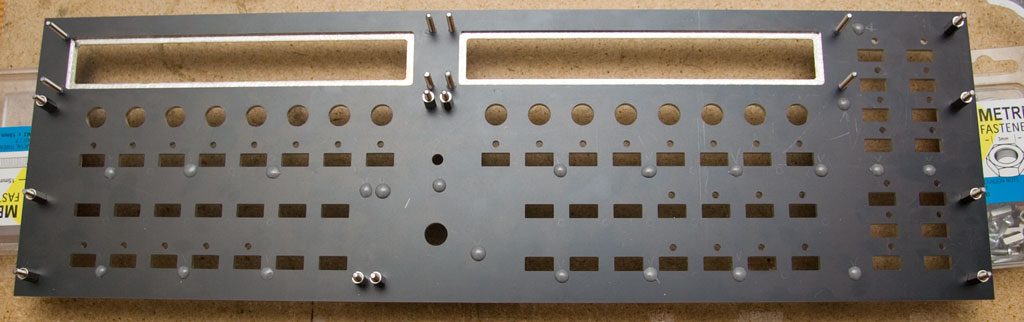

Using a panel made by FPE/Schaeffer
If you are using a panel made by FPE/Schaeffer, then you need to attach screws to the panel to make “studs”. (Studs are like a screw shaft coming out of the panel). The studs are meant to attach the panel to a case and also support the PCB to the panel. Studs can be made out of 18mm lengths of M3 threaded shafts. Take a 20mm or longer M3 screw and cut it to 18mm of shaft using a Dremel and grinding disc. You can then round off the cut end by rolling it at a 45 degree angle on the Dremel grinding disc. Do not round off both ends! Later, you will put the screw's original end (the end that wasn't cut) into the threaded holes of the panel.
Gently screw the studs into the threaded holes of the panel. You do not want to damage the aluminium thread by accident.
Place the PCBs onto these studs and flat against the panel. You can now mark a circle on the panel with a pencil where you will place JB-Weld to glue the threaded spacers, i.e. through the mount holes of the PCB. You do not need to use as many threaded spacers as mount holes in the PCB. (The three mount holes without plating are for optional mounting of an ultracore PCB).
This picture shows where I located the spacers.

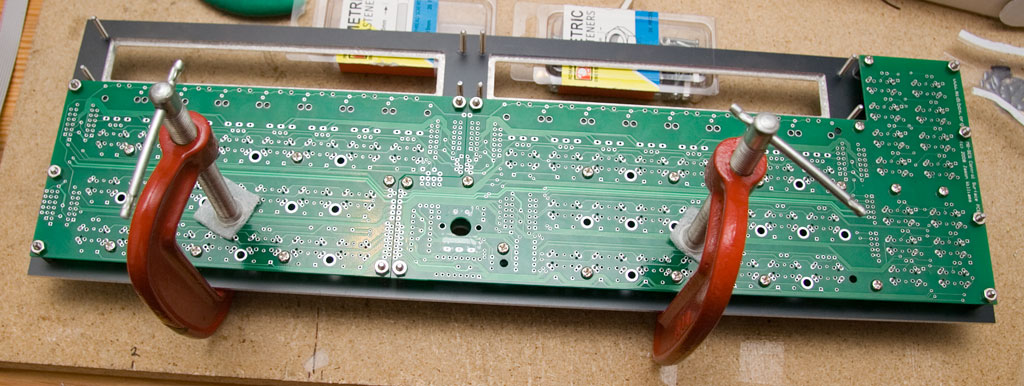

Here's where we repeat what you did before:
Place the PCBs on the studs. Adjust the PCBs until they are aligned across the join. Use the pad holes as the best guide. Ideally the PCBs should fit together exactly. It's important to ignore the PCB outer edge and concentrate on the alignment between the two pads for the Beat LED, and that the studs are in the middle of the PCB mount holes. Once aligned, screw the nuts on the studs, flip it over and look at the switch caps.
Add clamps to hold the PCB parallel to the panel. Sometimes the PCB might have a slight bend to it, observable by it being flexible in the middle even though you've used nuts on the outer edge. The clamps will push a few more of the spacers into the glue.
NOW LEAVE IT ALONE FOR AT LEAST 12 HOURS!!!

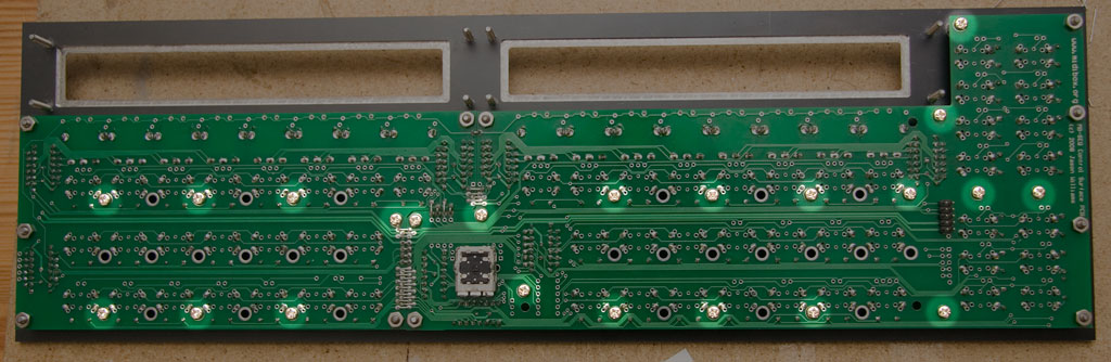

The LEDs should be soldered with the PCB and panel attached and perfectly aligned. The two parts of the PCB should also have been joined with soldered wire before soldering LEDs.
Rehearse/practice the following phase with a couple LEDs - inserting LEDs into the PCB, attaching the panel and flipping the panel and PCB.
NOTE THE ORIENTATION OF LED31/“step view” - it is opposite vs. the other LEDs!
Place LEDs into the PCB. Take extra care when placing the LEDs into the PCB. In particular, the Step View LED is of a different orientation to others nearby. Attach the panel. Flip the attached PCB and panel. Lay it down with the panel slightly raised so the LEDs can fall into the holes (the switch caps and/or encoder shafts keep it raised). Use LED leads to position LED into the panel holes. Solder the longer leads of all the LEDs. Check all the LEDs are at the same height - ones that are not can be adjusted by pushing the LED while reheating the solder joint.
If you are not using the exact same LEDs as I used, I suggest choosing resistors to match the LEDs you are using. In particular, it is likely the brightness of the bicolor LEDs will not be the same as the single color LEDs used, and you do not want the “step” LEDs being too bright, as often all 16 will be lit. Do this on an experimenter's board with a 5V supply. Even though it is hard to believe, LEDs in an 8-column matrix, i.e. which are only lit at most 1/8th of the time, are only slightly dimmer than when powered with a constant supply. Therefore, whatever brightness you get using a constant 5V supply will look good in the LED matrix.
I used 220 Ohm resistors for SmashTV's green 3mm LEDs and 220 Ohm for SmashTV's red 5mm LED (the “Beat” LED). For the bicolor LEDs I used (and may come with your PCB), I used 470 Ohm for the green and 1K for the red.
