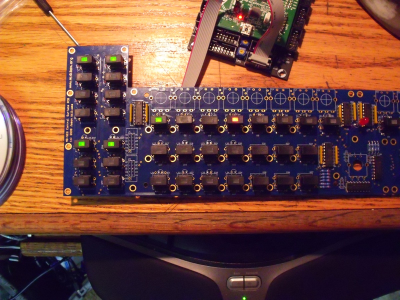

looks very good!!!
i assume this is the last pcb version, with the switch  tl 1240???
from the bom i read:
"The TL-1240 are short (8.2mm) so they cannot be used with encoders installed but are wired correctly for the LEDs. The Mec parts are tall and have a variety of caps but the LEDs are NOT wired to anything despite having pads and will need to be wired by hand. The 3 pin LEDs cannot be used with these switches. Only the 3F Mec parts are suitable, the 5F and others may fit the footprint, but use a different scheme for the LEDs that wont work at all with this board"
What are these wonderful caps???
So you manually wire the led on the back of the pcb??
How did you do for the bi color leds , as it was stated not doable on the bom???
what's the problem with the encoders, i don't really understand????
many thanks for your tips and hints, i'm looking to make one, and this look wonderful!!
bye
florian
Posted (edited)
just found your dedicated post
anyway thanks for your reports!!
