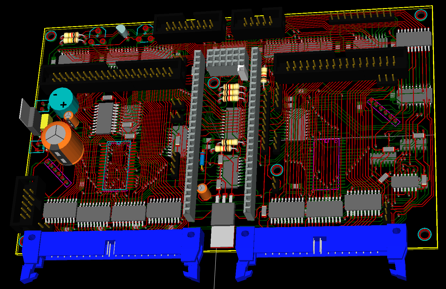

ilmenator Posted August 13, 2011 Author Posted August 13, 2011 Here are a few more pictures of the ugly prototype and development board. The transition from PIC core to the STM32 core on the way required a number of stack boards, e.g. for voltage level shift on the buses, that I had not anticipated when I had the protoboard made... As I said above, the next generation board will carry the LPCXPRESSO board - and will be much cleaner then. Here is the user interface, basically a CURSOR cross, ENTER and CANCEL buttons, as well as two dedicated FUNCTION buttons. Here is the card reader for the PROG (RAM/ROM) cards - taken from an old mini computer device. As you can see, I had to use a lot of SMD devices - on both sides of the PCB. The board would have become too big using only through-hole components. Also, some of the components in the original design were only available as surface mounted devices. But the SMD pitch used is still rather DIY friendly :smile: . Best regards, ilmenator

nebula Posted August 13, 2011 Posted August 13, 2011 (edited) This is fantastic. I will be watching this closely... suddenly I feel a need to free up a rack space beneath my WS A/D. I never owned a SAM1, and I never even owned a PCM card. So I'll build this for sure. But may I suggest your final "shield" board include a footprint for a readily available SD Card socket? Many years ago (in the mid-1990s) I used to run the majordomo mailing list for the Wavestation. It was pretty cool seeing you scroll through old Ben Hall patches. Nice work! Edited August 13, 2011 by nebula
ilmenator Posted August 13, 2011 Author Posted August 13, 2011 Thanks nebula! I remember being on the majordomo list as well - so we've known each other for longer than MIDIbox... :tongue: The shield board will not feature the SD card socket, but a DIL socket to run a cable to a daughter board, just like on the LPC17-based core. This is because I imagine people to want different configurations of / cases for the SCE. And then it is not clear what the best position for the SD slot would be. On top of that, there is simply no more space on the board, and I do not want it to become larger - look at the KiCAD rendering in one of my earlier posts. As it is now, it has the "Euroformat", i.e. it is 100x160mm, which is pretty much a standard size. Easy to ship, easy to find a case for. Ahh, by the way, it was exactly my intention to place this thing below the A/D in the rack. Maybe abuse an old Korg M3R? :angel:
