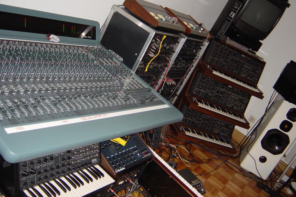

TK. Posted February 14, 2004 Posted February 14, 2004 The AOUT works perfect and has been successfully tested with this equipment:http://www.midibox.org/midibox_gallery/francois1.jpgThe reason why the MBHP_AOUT hasn't been officially released yet is just that I'm planning to create a 64 multiplexed channel extension with S&H chips which will require an extension port. Once the MIDIbox SEQ has been finished, I will continue with this design.Best Regards, Thorsten.
