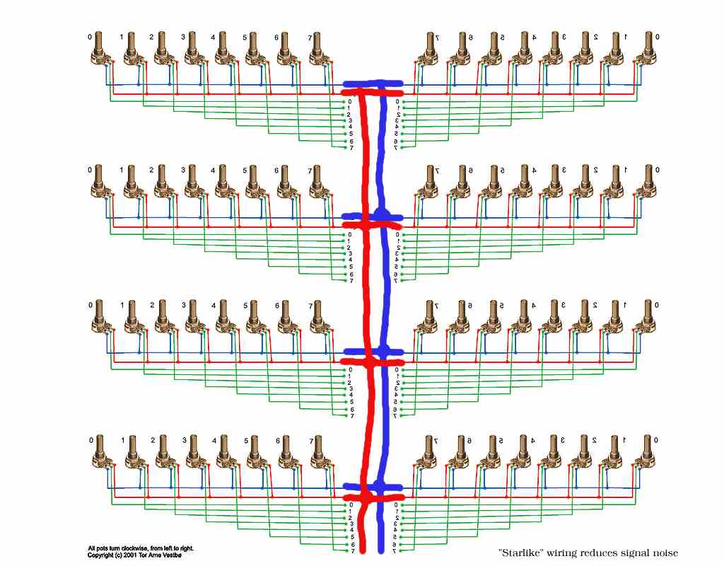

Starlike-Wiring
Starlike Wiring helps to reduce jitter!
Read the description here: http://www.midibox.org/users/tor_arne/midibox64_walkthrough/potsbuttons.html
