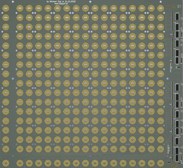

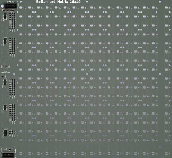

BLM16x16+X V2 - Board
for TriggerMatrix4 i used Latigid ONs PCB: blm16x16_build_guide, but i had only 2 PCBs, one for me, and one finally got Maxim Anokhin (Limewax), in order to get more Triggermatrices into the world I made my own Version for the upcoming triggermatrix5

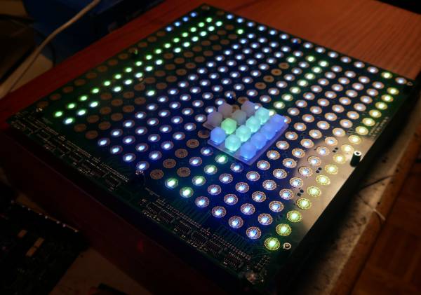

To Do
waiting for the Prototype to come, then solder hundrets off components
