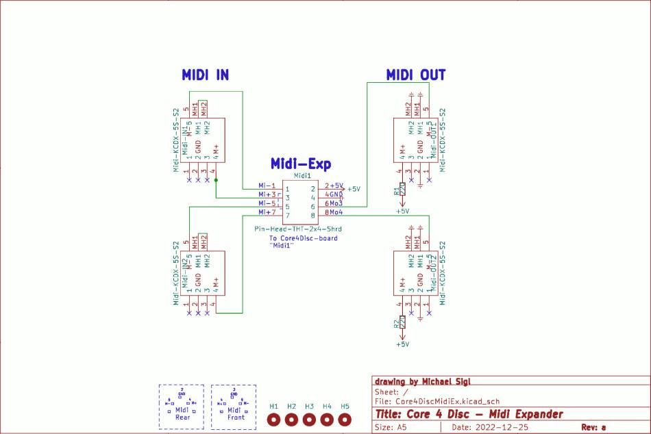

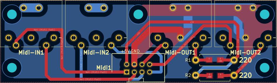

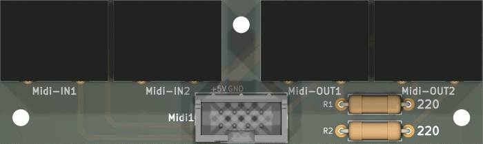

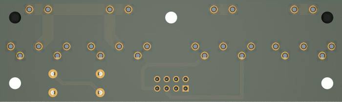

Core4Disc Midi-Expansion
this is one essential part for my triggermatrix5
Shematic
Building and BOM
Handsolder, easy project…
BOM
