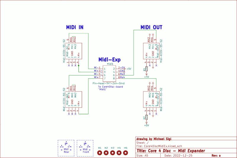

Shematic

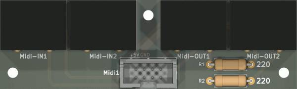

Building and BOM
Handsolder, easy project…
BOM
^Qty ^Reference(s) ^Value ^Footprint ^Mouser^
1 | Midi1 | Pin-Head-2×4 | PinHead-Shrd-2×4-THT | 649-75869-232LF |
4 | Midi-IN1-2, Midi-OUT1-2 | Din 5Pole | KCDX5SS2 | 806-KCDX-5S-S2 |
2 | R1, R2 | 220 | THT or 1206 | SMD: 660-RK73B2BTTD221J THT: 281-220-RC |
R1 and R2 can be solderd as Thruhole, or SMD1206 Package
