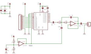

Hardware
v0.1
The hardware of the first version consists of a standard core board and a DAC module with a anti-aliasing filter
Schematic
Connection diagram
connection to core:
| coresound pin | core pin | pic pin nr |
| 1 | ground | - |
| 2 | J15:D7 | 40 |
| 3 | J15:D6 | 39 |
| 4 | J15:D5 | 38 |
| 5 | J15:D4 | 37 |
| 6 | J15:D3 | 36 |
| 7 | J15:D2 | 35 |
| 8 | J15:D1 | 34 |
| 9 | J15:D0 | 33 |
| 10 | J14 | - |
| 11 | +5v | - |
