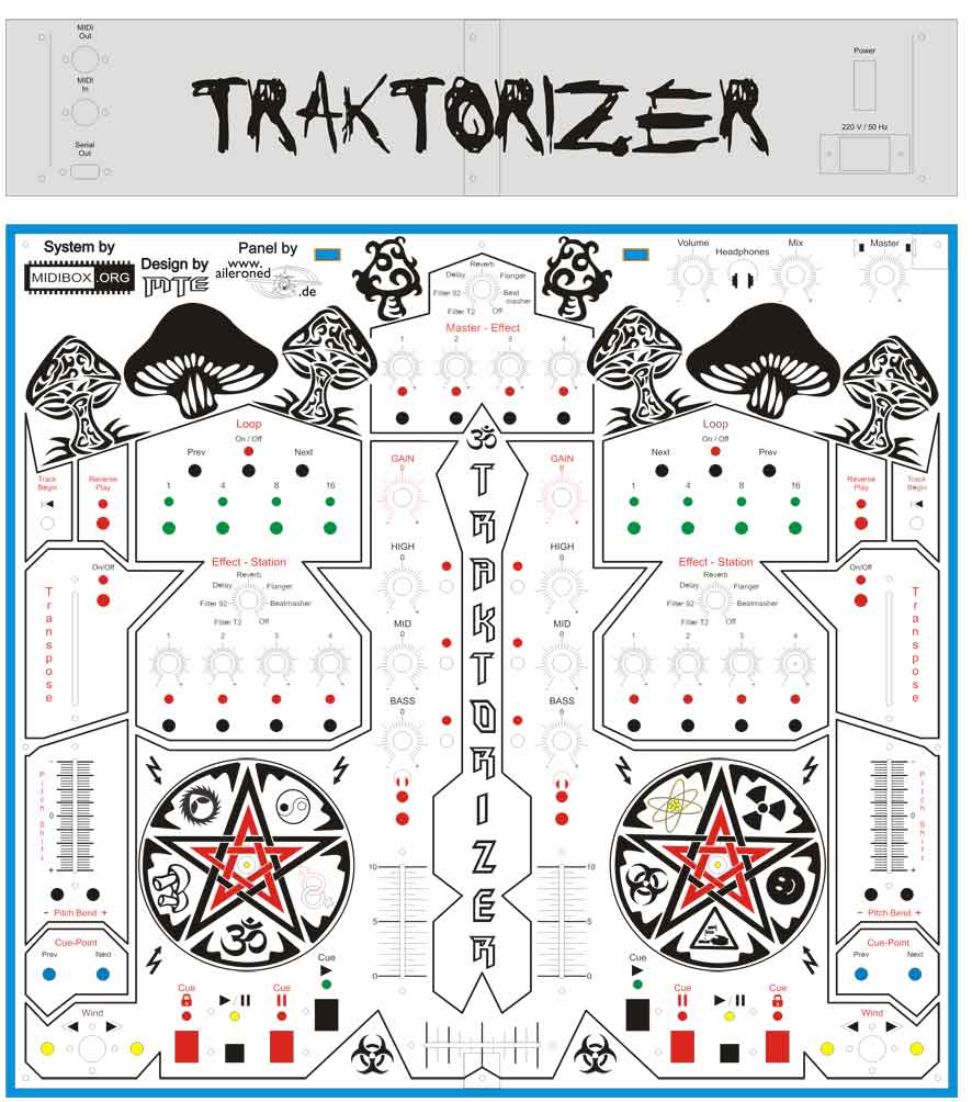

- Mixing For Traktor V.2 / V.3….only 2 Decks !
- Volume, Low/Mid/High-EQ-Pots + Kill-Buttons, Gainpots
- Crossfader
- Deckeffect-section - Effectselection via Pot
- Loopsection - 1,4,8,16-step buttons, prev-next Buttons
- Reverse Play
- Track Begin Button - when a Track is running out and you want to switch the other track from -cue to -startposition
- Transpose Fader
- Pitchbend - with Jogwheel (Encoder) and Buttons
- Windfunction - with Encoder and Buttons
- Mastereffectsection - also Effect-selection via Pot
- Mastervolume , Headphone-Volume and Headphone-Mix - via Pot
- Midi In/Out and Serial Interface

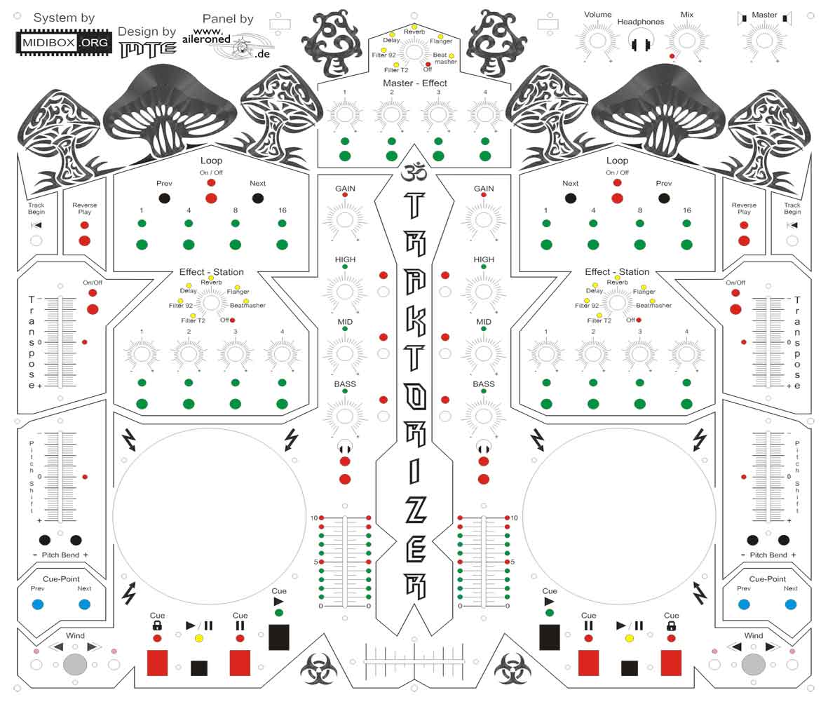

- LED-Arrays on both Volume Faders
- LEDs on Effektselection-Pot, you can see now via LED which Effect is selected
- Pot-Middle-Position on Bass/Mid/High/Gain now signalized via LED
- same function for Pitch-shift,Crossfader & Transpose-faders
- one LED putted on Headphonemix-Pot, for “0”-Position
