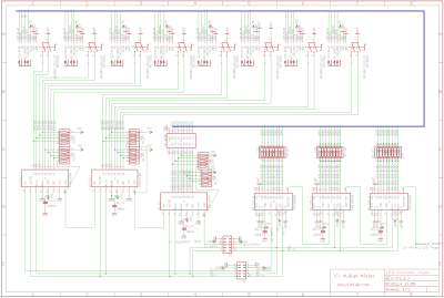

A PCB to add 8 Encoders with LED ring for each.
Eagle Files: https://github.com/novski/Midibox/tree/master/VLR-8Enc
BOM
BIll of Material
Allways look for the cheapest seller, the Price may vary heavy!!! And look for Local dealers preferred. http://www.midibox.org/dokuwiki/doku.php?id=where_to_order_components

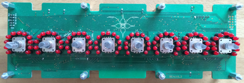

How to get Started
If its your first SMD soldering you can follow this on t1:58 : http://www.youtube.com/watch?v=5uiroWBkdFY I recommend to not buy solder paste, instead buy some flux-paste like this on Mouser: 590-8341-10ML
Prepare the PCB
Start with the SMD parts and then go on the the conventional parts also on the Bottom side. Don't forget the R11,12,13. Then go on with the Topside and the LEDs before soldering the Encoder as last. Check the Connections with a Lens.
Prepare the Connection
Connect the core on J8/9 to J1 of the VLR-8Enc board.
Test it in MIOS

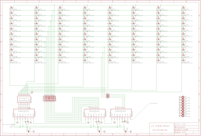

To make it work with MIOS .NGC File we need to know how the shift-registers are connected.
Inputs:
1# Encoder 1-4
2# Encoder 5-8
3# Encoder Button 1-8
Outputs:
1# RED Shaft LED 1-8
2# GREEN shaft LED 1-8
3# BLUE shaft LED 1-8
4# LED Ring Row 1-8
5# LED Ring Selct 1-8
6# LED Ring Select 9-11
Assuming that the VLR-8Enc is the first device on the chain of J8/9 we need to configure it like this:
