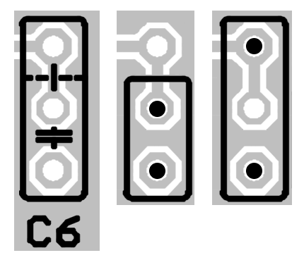

Soldering info
All capacitors (except for the crystal bias caps) have a dual-footprint to allow for using 100mil or 200mil (2.54mm or 5.08mm) spaced capacitors. The image below shows how to mount either one. The first column shows the silkscreen you'll find for capacitors, while the second column shows the mounting position of 100mil (2.54mm) capacitors and the third column shows the mounting position of 200mil (5.08mm) capacitors.
