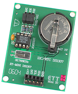

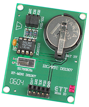

well, more exactly, this dev board : (USD $6.90)
http://www.futurlec.com/Mini_DS1307.shtml
This board hold a battery back-up, enabling the time to be maintained even with power disconnected from the board. The DS1307 IC stores time values in separate registers, for years, month, day, hour, minutes and seconds. I suggest to use this board, as it's cheap, it will save you time on building, and debuging :)
Connection to core
Well, that's pretty easy : connect Gnd,Vcc,Sc,Sd to Core J4. (instead of bankstick)
I did not add a pull up resistor between Vcc and Sc (well, in fact i did, but i didnt notice any difference)
