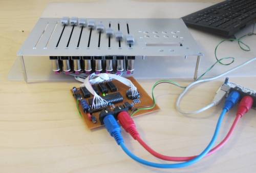

The MF_NG module is the successor of the MBHP_MF module and has following design targets:
- find a solution to handle high-quality faders like Alps K faders with “coreless” motors
- find a solution for Core32 which doesn't deliver stable enough ADC conversion results due to the reduced 3.3V voltage range
- find a solution for Core32 which cannot handle touch sensors properly without heavy CPU load (resp. without an additional external device or microcontroller)
- find a solution which is compatible with PIC based projects for best usability
- find a solution which is DIY friendly and doesn't require additional gear for something which isn't part of the MBHP yet
- find a solution which can be easily tested and troubleshooted (no need to learn new processes)
And the result is:
- a dedicated PIC controller controls the motorfaders directly.
- the firmware can be updated via MIDI!
- motorfaders are accessed via MIDI - this allows standalone usage, cascading (to chain multiple modules), and the re-use of existing infrastructure such as MIOS, MIOS Studio and MIOS Bootloader
- the module can either be connected to a PC directly, or controlled from a second PIC or STM32
- native support of various protocols (e.g. PitchBender, CCs, even Logic Control and Mackie Control Emulation)
- support for 8 touch sensors
- instead of TC4427 I'm using L293D now - not at least because of the integrated diodes.
- due to the direct motor control connections, the PIC is now able to generate PWM with 50 uS steps for improved motor speed control while a motor is moved
- since the firmware is dedicated for this task, there was enough memory free to integrate advanced features, such as runtime-calibration and motor position tracing which are supported by MIOS Studio
