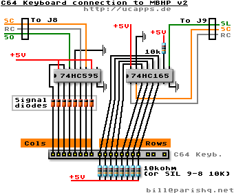

The MIDIBox AY has no Encoders or Buttons - but a C64 Keyboard.
The Commodore 64 Keyboard
Interconnection (C64 Keyboard - MBHP DIN/DOUT)
The C64 Keyboard must be connected to the MBHP DOUT (DOUT1: J3(Pin D0 to D7)) Board and MBHP DIN (DIN1: J3/J4(Pin D0 to D7)) Board
See DOUTX4 ⇒ http://ucapps.de/mbhp/mbhp_doutx4.pdf
See DINX4 ⇒ http://ucapps.de/mbhp/mbhp_dinx4.pdf
See also MidiBoxKB by billmidiboxkb_-_using_a_c64_keyboard_as_input
