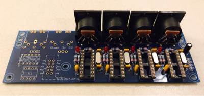

Quad_IIC_MIDI Board parts list
The IIC MIDI module provides a bridge between IIC and MIDI, and mainly consists of a PIC16F88 microcontroller from Microchip, which runs with a special firmware (not MIOS!).
Parts List
Description Type Quantity Reichelt Ref Mouser Ref Digikey Ref
IC1-4 PIC16F88(Must be programmed) 4 579-PIC16F88-I/P
IC-Socket for 16F88 4 575-199318
LEDx 3mm LED red 4 696-SLX-LX3044HD
Q1x 20mhz crystal 4 559-FOXS200-20-LF
C3 10µF Electrolytic capacitor 1 647-UKL1V100KDDANA
C1x,C2x 15pF Ceramic capacitor “33” 8 581-SR151A150J
C4x 100nF=.1µF Ceramic capacitor “104” 4 598-M20U104M5-F
R2x 220Ω resistor 4 660-MF1/4DCT52R2200F
R9x 220Ω resistor 4 660-MF1/4DCT52R2200F
R10x 220Ω resistor 4 660-MF1/4DCT52R2200F
5 pin DIN connector 4 502-57PC5FS
J4 1×4 pinheader 1 710-61201021621
——-—optional BLM connection parts—-—–
IC2 6N138 optocoupler 1 859-6N138M
IC2 IC-Socket for 6N138 1 575-199308
R6 1KΩ resistor 1 660-MS1/4DCT52R1001
R7 4.7KΩ resistor 1 603-MFR-25FBF52-4K7
R8-R10 220Ω resistor 3
D1 1N4148 diode 1 512-1N4148
8 pin DIN connector 1 490-SDF-80J
Box Header 2×5 1
