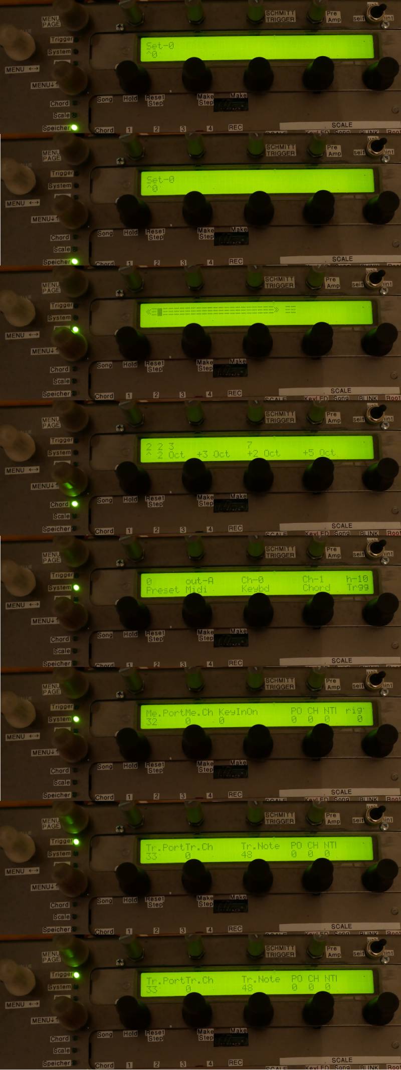

Then i run into the problem, that i dont remember of that thousends of scales which are possible when playing melodys… Scale Explorer was born, i broke down 2400 scales to 240 Scales (by letting the root note a variable which can be set on the UI on the fly

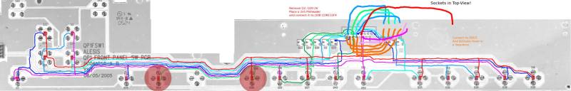

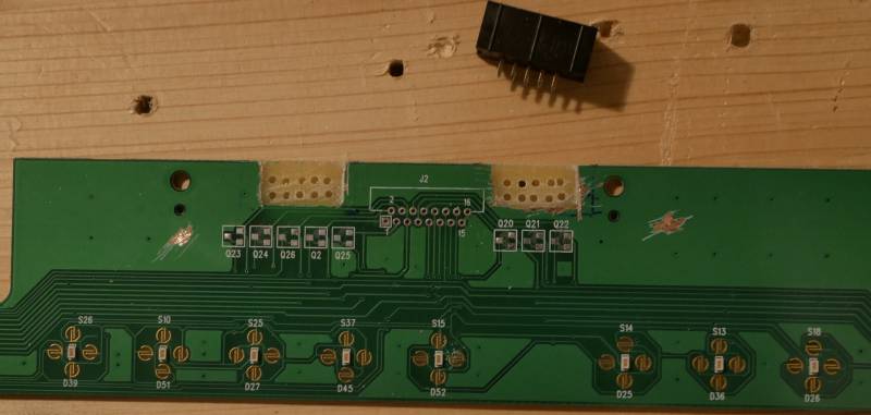

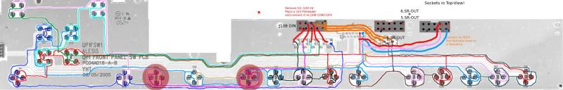

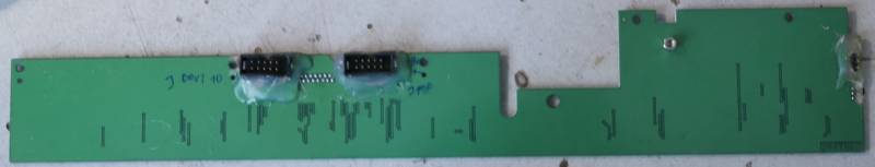

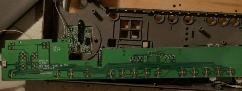

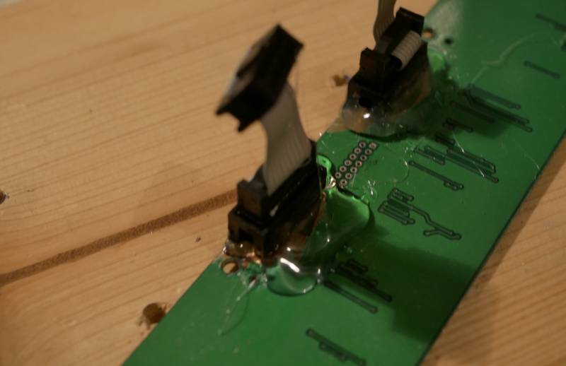

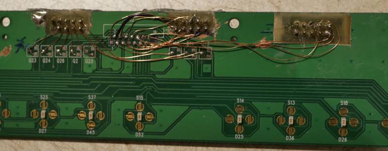

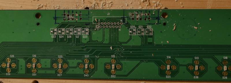

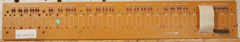

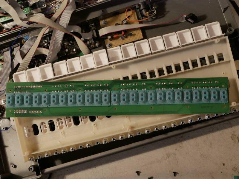

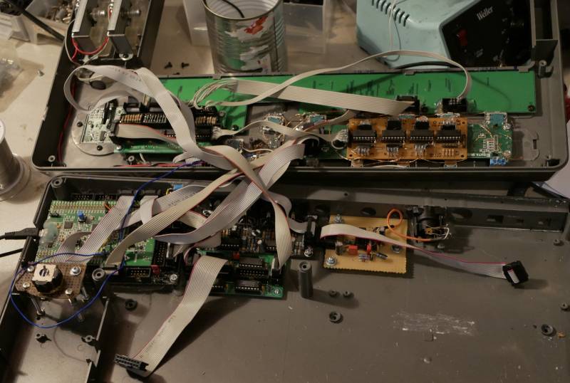

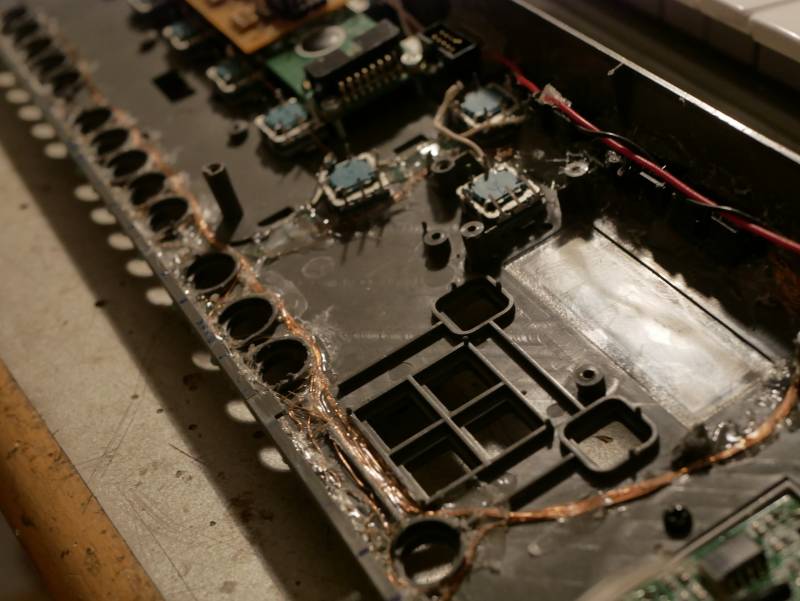

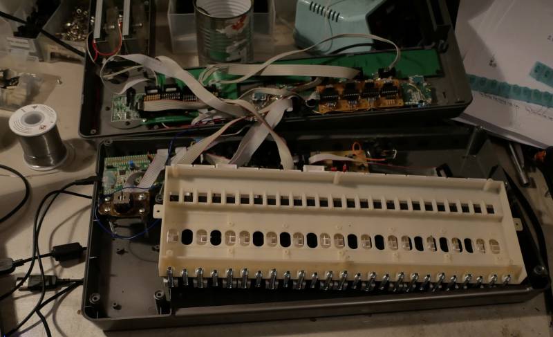

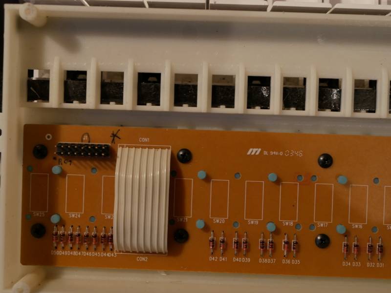

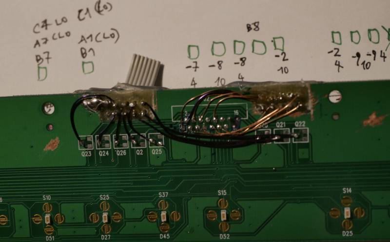

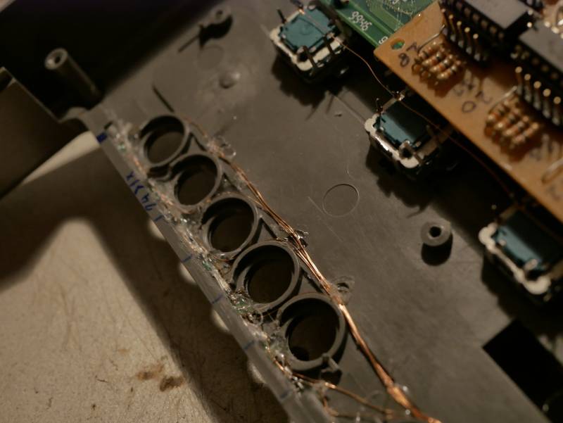

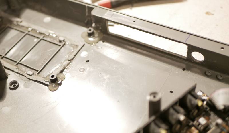

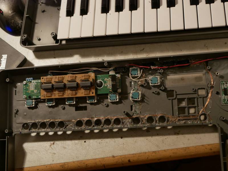

For that i took a Alesis PhotonX25, and replaced the Microncontrollerboards with the Midibox ones
Some Things still dont work like the XYZ-IR-Controller, or the Pitchwheel…however, after 2 months of hard work and programming it is working now! YEAH!

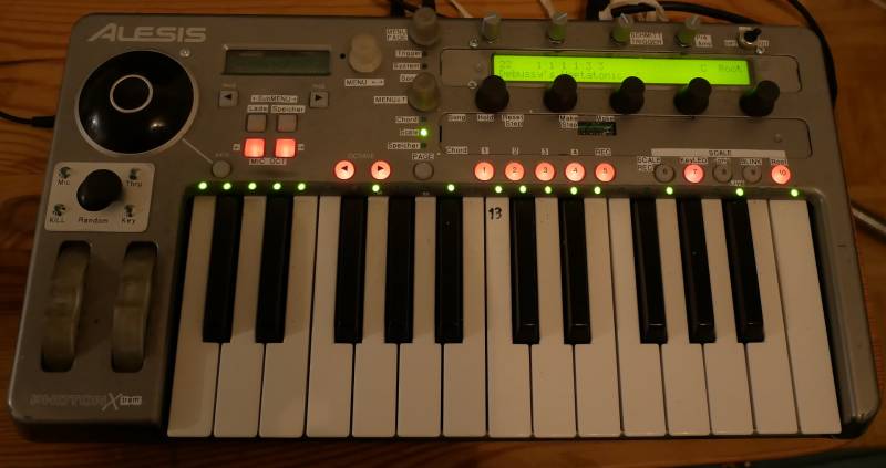

explore a lot of musical scales, and learn keyboard playing

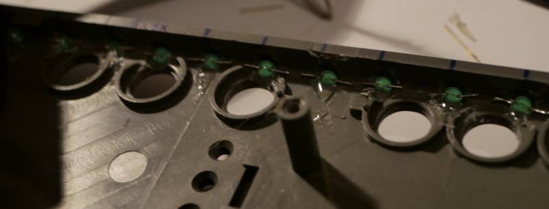

by showing the “right” notes via LEDs above the Keyboard Keys

Change the RootNote on the fly
Record a Song
Play a song via Drumtrigger
Record Scales
Identify Scales from other Keyboardplayers on the fly - easyer jaming
For absulutely Keyboard Newbees like me!
add Chordnotes or Octaves to get Organ Melodys
Show and modify Song-Steps via LEDs above Keyboard Keys!

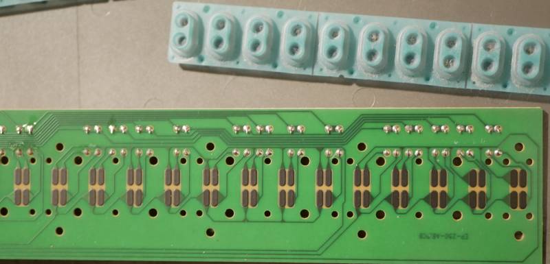

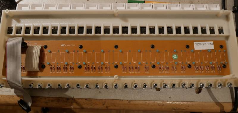

Velocity sensitive Keyboard Midification based on MB-KB
Only for 25Keys Keyboard hardcodet!
