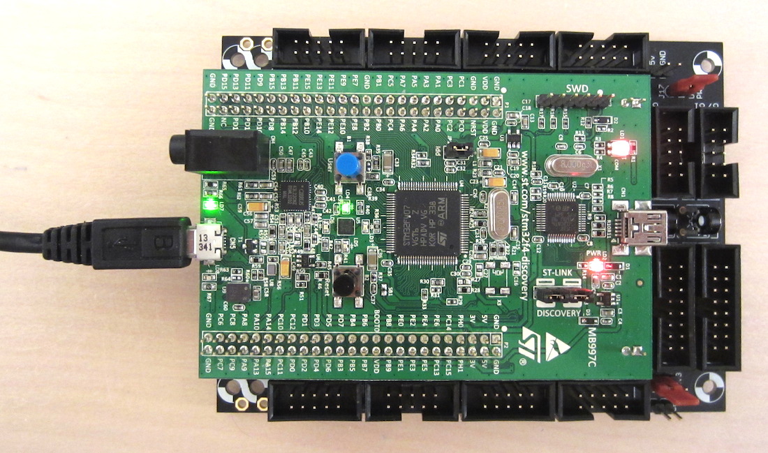

STM32F4 Core 32 Board parts list
Parts List
| Description | Type | Quantity | Reichelt Ref | Mouser Ref | Digikey Ref |
| STM32F4 Board | Mainboard | 1 | 511-STM32F407G-DISC1 | ||
| 74HC595 | IC | 1 | 74HC 595 | 595-SN74HC595N | |
| 74HCT541 | IC | 1 | 74HCT 541 | 595-SN74HCT541N | |
| BC337 | Transistor | 1 | BC 337-16 | 512-BC33740TA | |
| 4*1kΩ | Resistor | 1 | 1.0k | 652-4605X-AP1-102LF | |
| 1kΩ | Resistor | 2 | 1/4W 1.0k | 291-1K-RC | |
| 2,2kΩ | Resistor | 4 | 1/4W 2.2k | 291-2.2K-RC | |
| 10kΩ | Resistor | 1 | 1/4W 10k | 291-10K-RC | |
| 10kΩ Pot | Pot | 2 | PT 6-L 10K | 72-T70XX-10K | |
| 1N4148 | Diode | 1 | 1N 4148 | 512-1N4148 | |
| 100nF | Cap Ceram | 2 | Z5U-2,5 100n | 80-C412C104K5R | |
| DIP16 Socket | Socket | 1 | GS 16 | 653-XR2A-1611-N | |
| DIP20 Socket | Socket | 1 | GS 20 | 653-XR2A-2001-N | |
| DIL 2×5 Socket | Socket | 10 | PFL 10 | 538-87834-1019 | |
| DIL 2×8 Socket | Socket | 2 | PFL 16 | 538-87834-1619 | |
| DIL 25×2 Socket | Socket | 2 | BL 2X25G 2,54 | 649-66953-025LF | |
| SD Card Socket | Socket | 1 | SD-RSMT-2-MQ |
