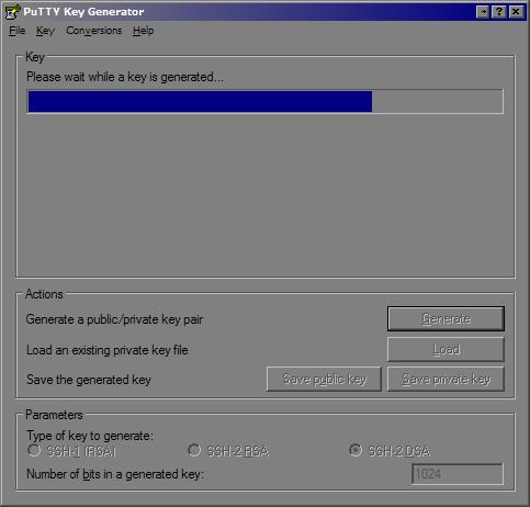

One of the applications in the PuTTY package is PuTTYGen. This tool gives us a simple method of creating the keypair. Run the program - you should see the icon in your Start Menu after using the above installer.
Change the key type to SSH-2 DSA, and click 'Generate':
Wiggle your mouse around in the big grey space, to create random input for the program:

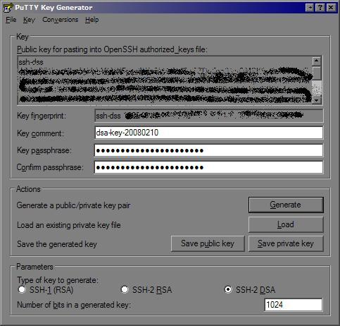

Once the key has been generated, you can add a passphrase. This is used to protect your private key, which is kept on your local PC, from being used without your passphrase. Don't forget this! If you have a bad memory, I recommend you use a tool like KeePass to remember it (you can also save a copy of the keypair in KeePass as a backup)
Now, click 'Save Private Key'. This will create a file with a .ppk extension. Save it someplace handy, you'll need this later. Next, click 'Save Public Key'. This will create a file with whatever extension you specify, you could name it as *.pub. Save it with your private key.

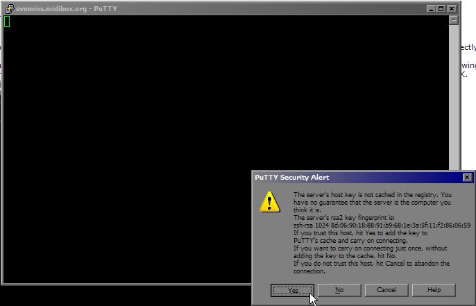

You will see a terminal window open, if this is the first time you connect (which it probably will be) then you should be prompted with the following message:
Click Yes if the SSH fingerprint in your message matches the one in this picture (means that it's really midibox.org you're talking to) and you should not see this message again.

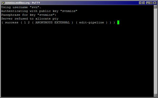

Next you will be prompted for your private key's passphrase. Type it in, and you will see the following screen. Note the error, “Server refused to allocate PTY” is a cosmetic error, and is totally normal. Other errors probably mean you did something wrong ;) Close the screen when you've confirmed that all is working OK.
Note that if you are prompted for a password, then your SSH keypair has failed. If you're sure that TK has added your public key, then your session config may need checking.

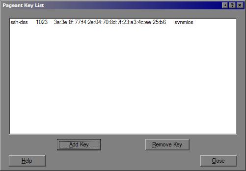

Double click the icon, and you will see a mostly empty window. Click the button labelled 'Add Key', and browse to your private key (*.ppk). When you click 'Open', you will be prompted for your passphrase.
Type it in, click 'OK', and you should now see the Pageant window has your private key added:

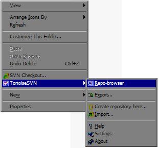

Right click in the folder, and you will see two new items in the context menu, TortoiseSVN (which is a submenu)', and 'SVN Checkout…'. Below the TortoiseSVN submenu you will see the Repo-Browser, which could be a good tool to test, but instead, we'll go ahead and do a Checkout.

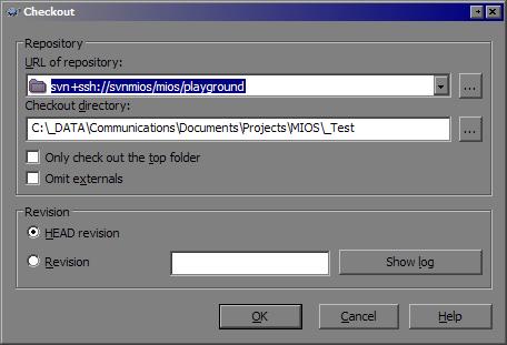

Once you select the 'SVN Checkout' menu, you will be presented with a dialog box titled 'Checkout'. In this window, you can enter the URL to the repository. In our case, there are two ways to do so.
If you are using read-only access, then you should use:
svn://svnmios.midibox.org/mios/playground
If you are using read/write access then you should use:
svn+ssh://<PuTTY Session Name>/mios
For example, mine is svn+ssh://svnmios/mios/playground:
