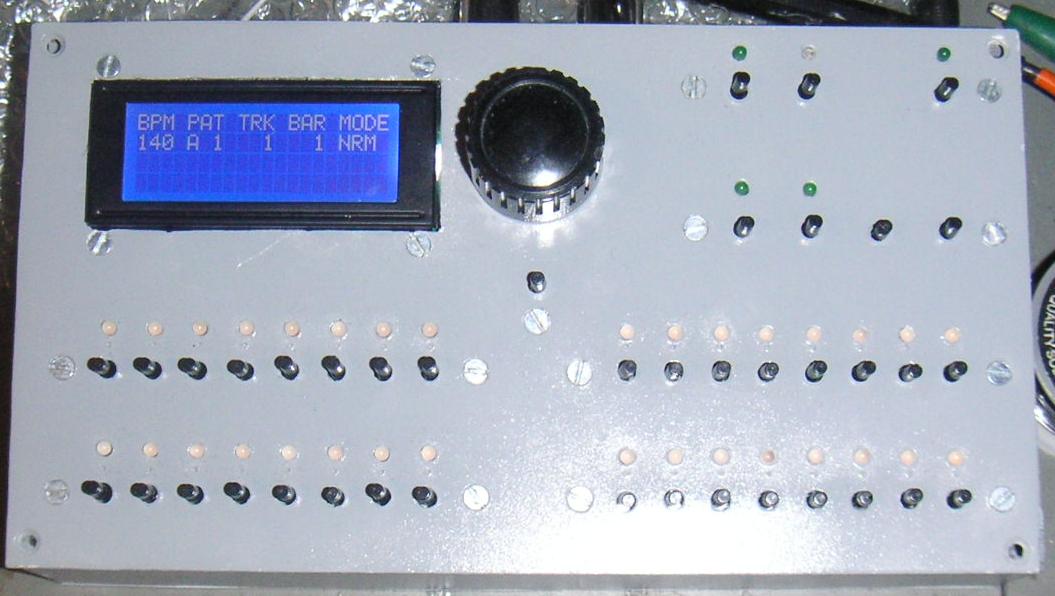

Interface
- lcd: displaying (bpm pat trknr edited_par)
- 32 step buttons + stepleds, leds are dual color to display trig/acc
- step edit behaviour: step off/trig/trig+acc
- all functions are accessed with a stepkey + shift combination
- pattern selection: stepkey + pattern button
- track select/mute: stepkey + track button
- rotary encoder for bpm, also used for editing values
- Step button layout:

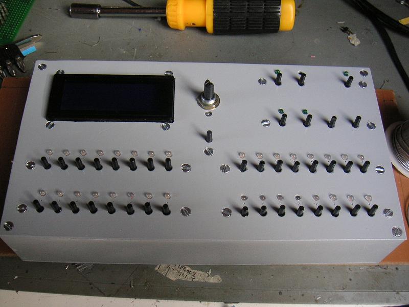

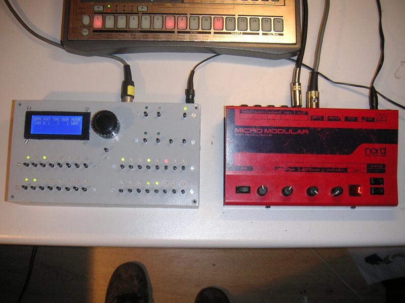

Progress

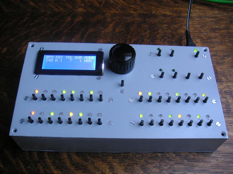

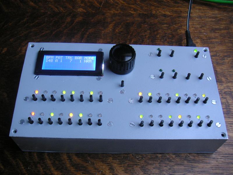

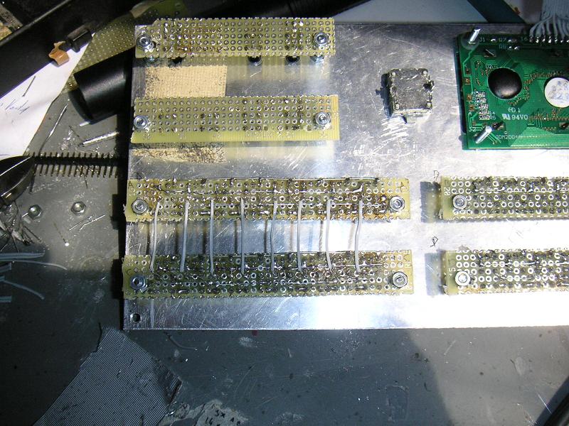

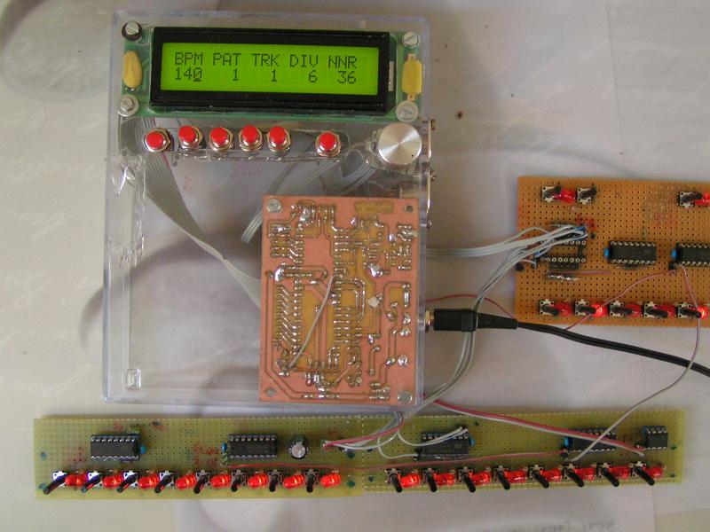

- first prototype

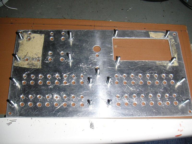

- new layout design
- ledmatrix/buttonmatrix finished (see matrix page)

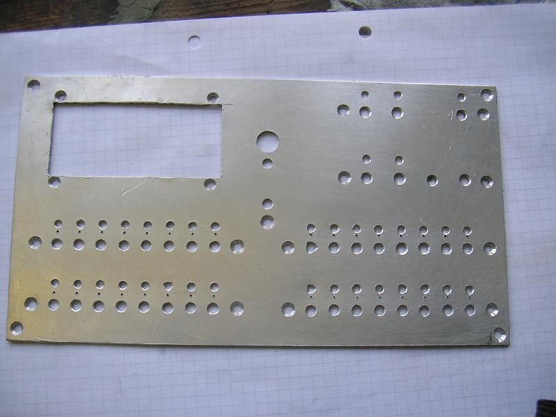

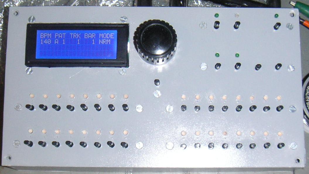

- frontpanel finished/wired
- first take on controll surface handler (step, track and pattern handling)
- sequencer works, timing is not stable yet

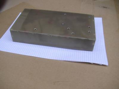

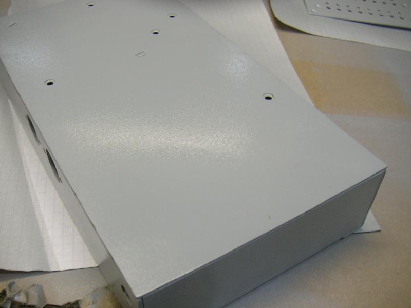

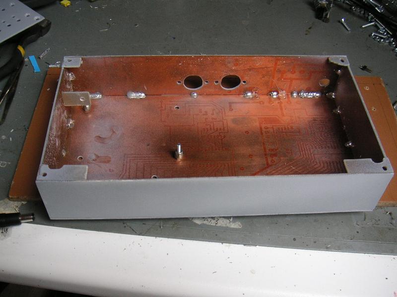

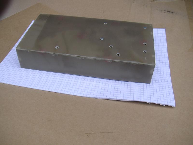

- made a temporary case
- fixed flickering leds when pushing a button
- bankstick error handling added
- default pattern is loaded when no BS is available at startup
- independant length/divider for each track implemented
- LCD optimalisations
- loading and saving of patterns works now
- backward playing direction implemented
- midi mode implemented with simple slave mode (no interpolation)
- improved bpm handling (pattern bpm is saved with pattern)
- fill function implemented
- CS interface improved (the edit functions are now accessed with stepbutton+shift)
- settings are saved in internal eeprom
- notetrack implemented, this track will be used to program basslines
- changed data structure, new pattern is 256bytes
- cs is updated for notetrack (shift + track selects notetrack)
- shift + stop resets the song position
- due to code/ram space limitations the project is ported to a pic18f4620
- the core board was modified so that the backlight can be controlled by the software
- new bankstick routines to handle the larger pattern size
- 2 new functions added: Seq Reset and Backlight mode
- CC layer added
- tracks don't go out of sync after changing divisor
- the note track now has a note length parameter
- pattern banks are implemented
- new function: shift track
- the note-on status of tracks is displayed in the track layer
- note-off handling when seq is stopped added
- the pattern bpm is now loaded when the seq is not running
- 0.7e
- pattern banks implemented, bug fixed in bankstick routines
- manual trigger and solo implemented
- basic sysex support
- songmode now works
- note length implementation for note track
- it is now possible to sync pattern changes to begin of pattern
- lots of core tick optimalisations
- obsolete functions removed

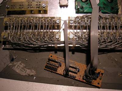

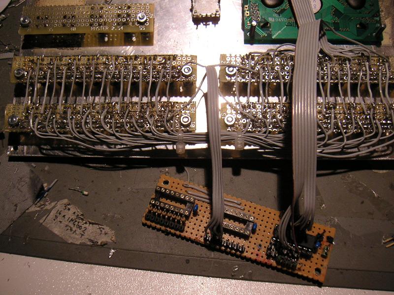

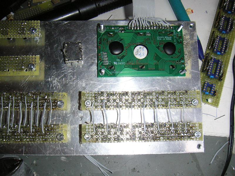

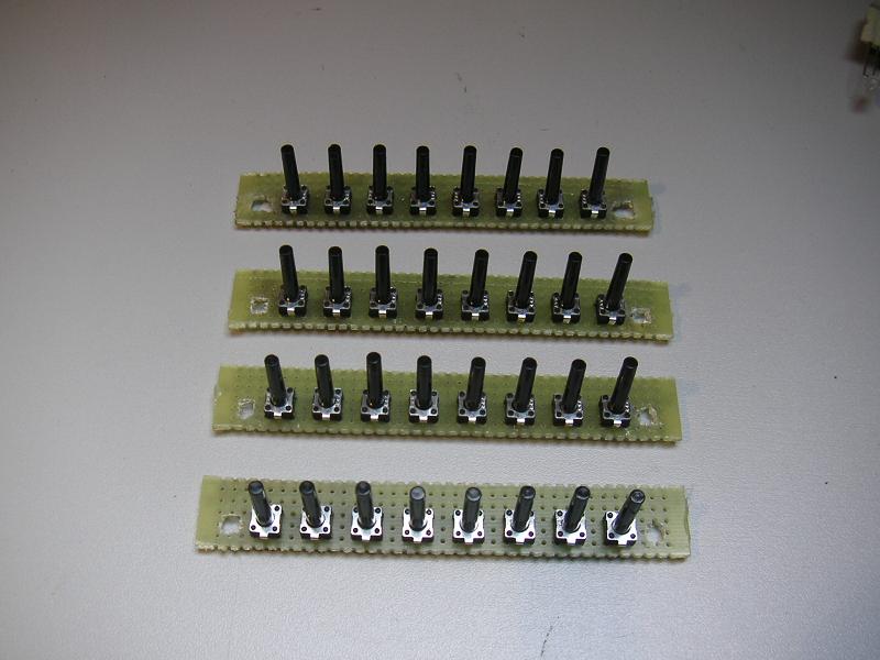

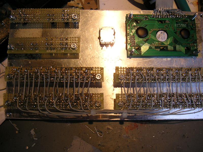

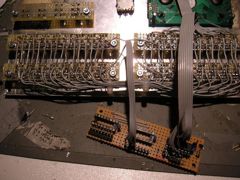

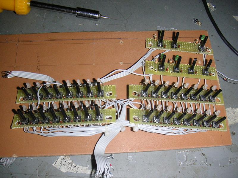

The leds/buttons are wired in a matrix configuration to reduce the number of DIN/DOUT modules needed DSEQ32_matrix

First prototype:
used for development of data structure, bankstick code, sequencer core
New version:

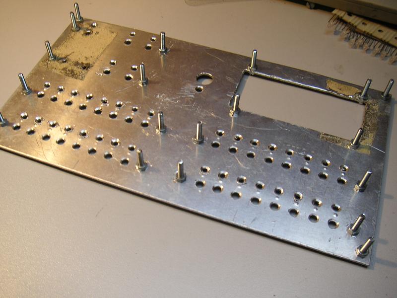

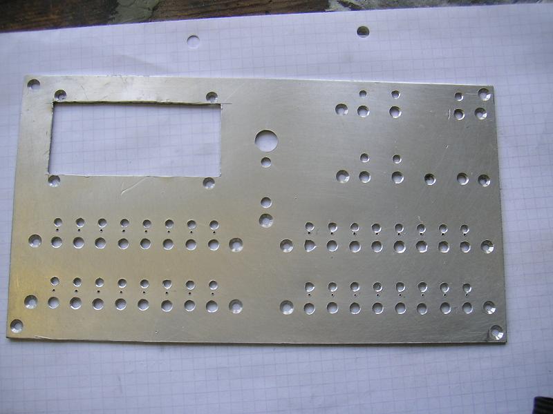

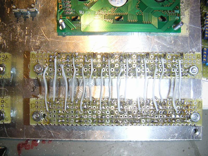

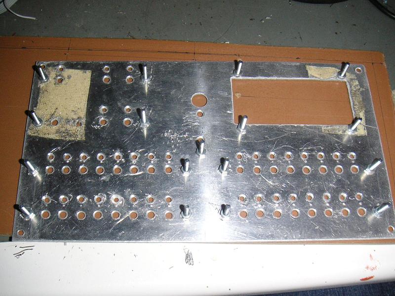

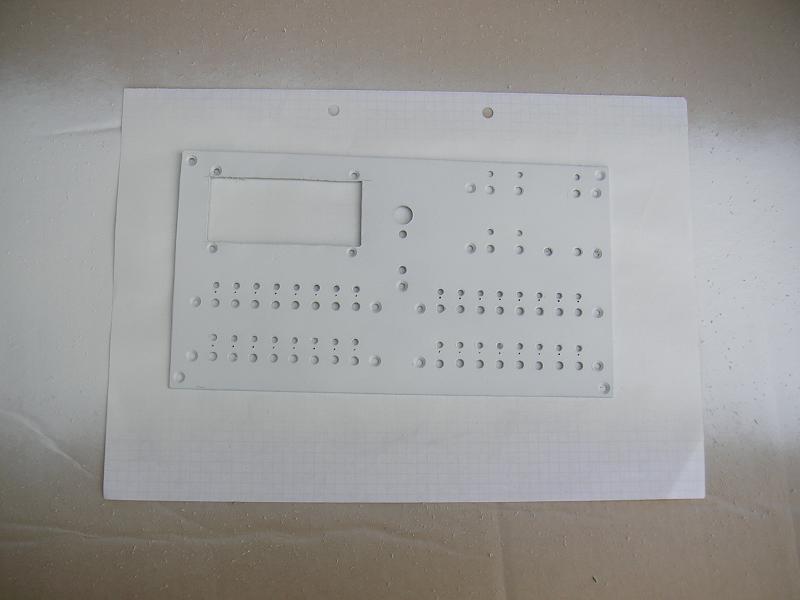

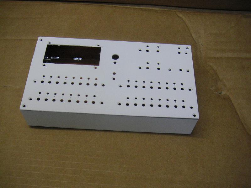

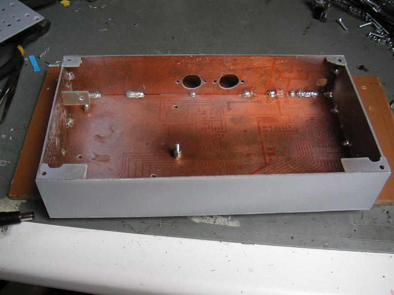

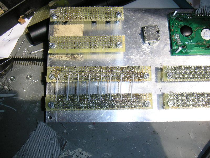

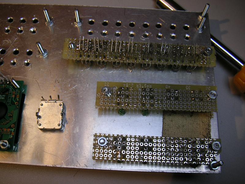

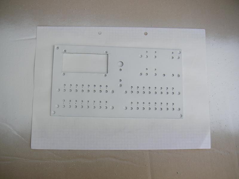

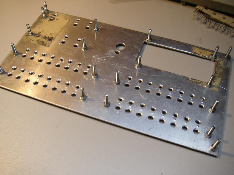

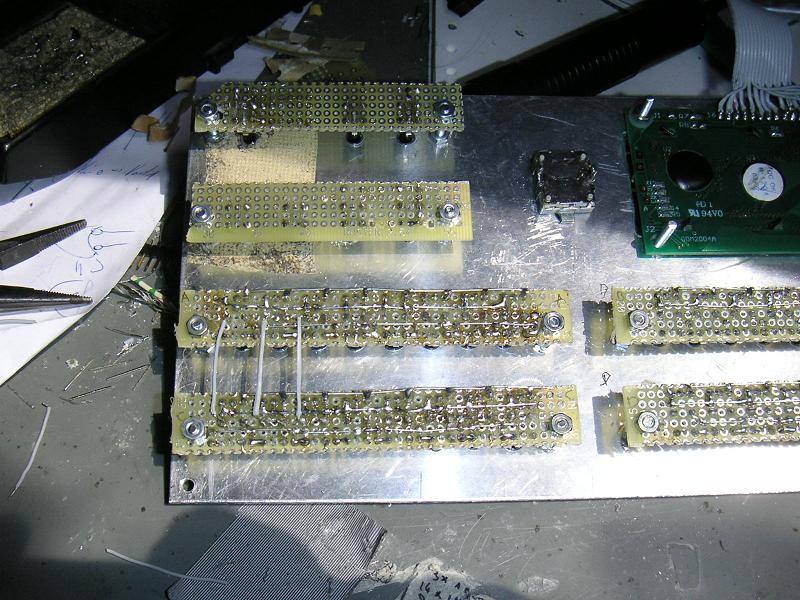

- Construction of frontpanel

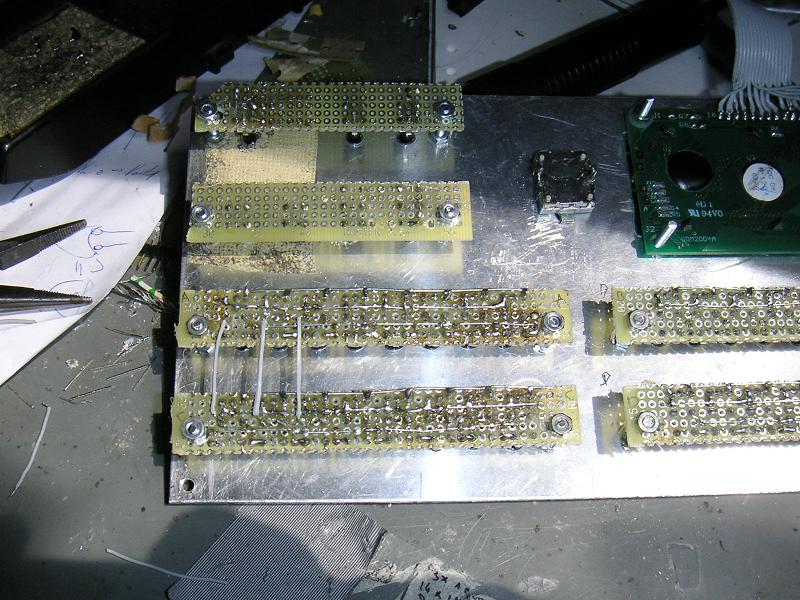

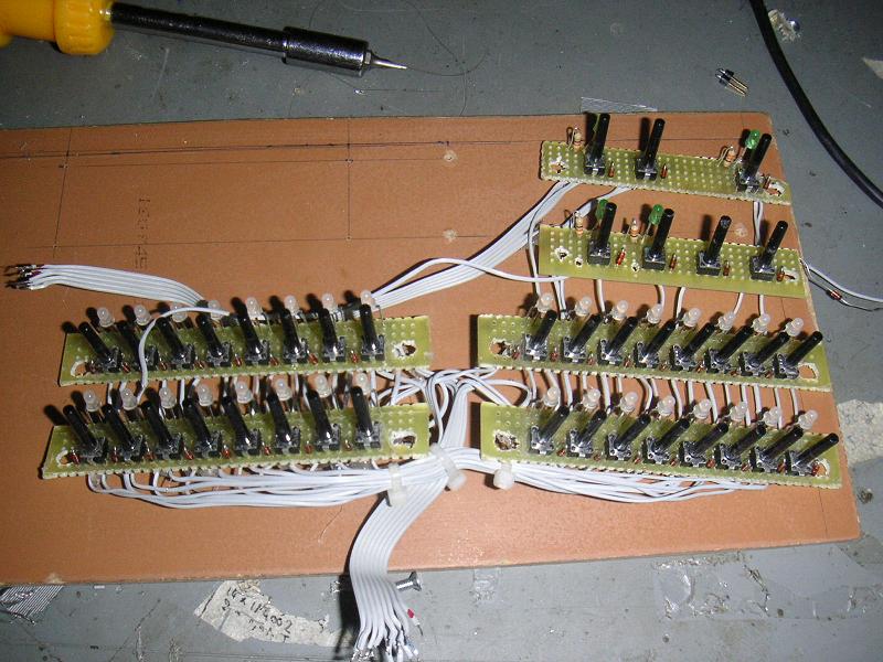

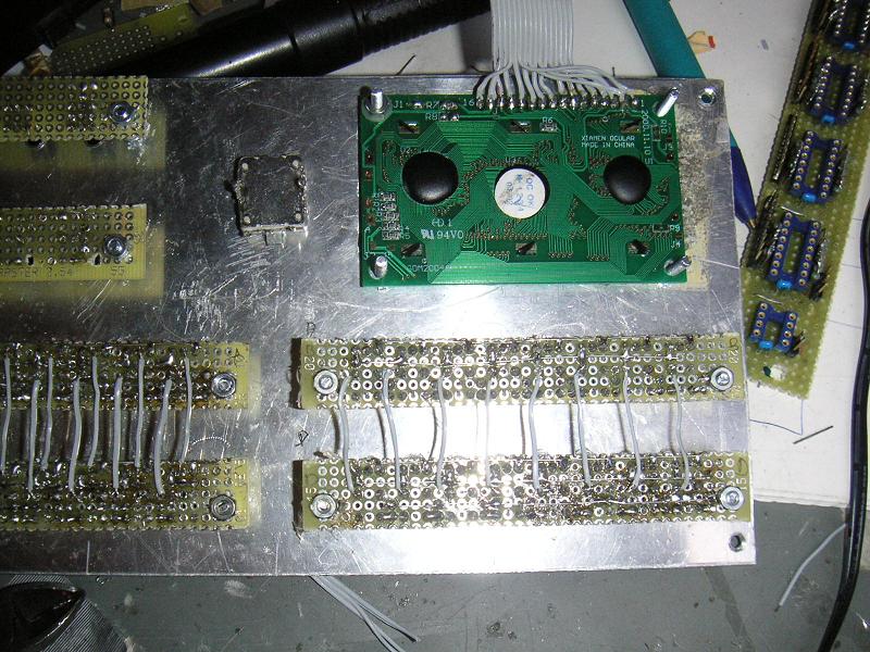

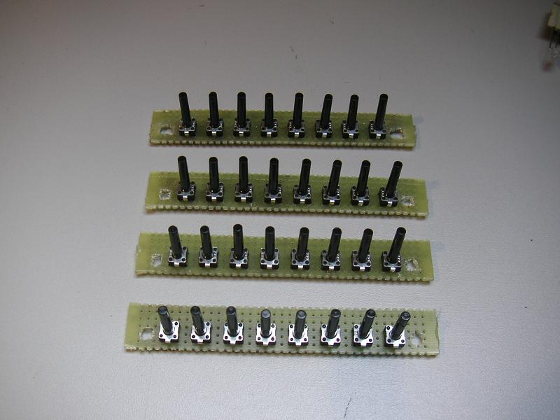

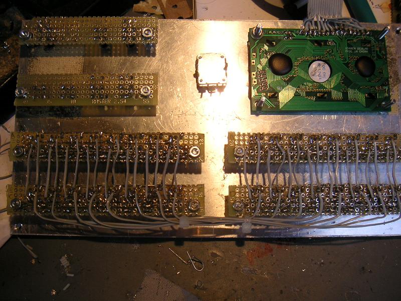

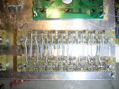

- Wiring of the 32 step leds/buttons

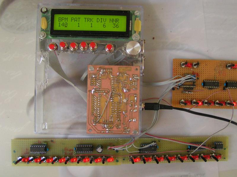

- Testing of the step buttons with the SM_example application
- Testing of the step leds with modified SM_example app (modified version includes leddriver)
- Development of user interface code
- Button and led handling finished
- The flickering led problem is solved with MIOS v 1.9c
- Encoder handling works, but there's still a small bug
- Updated LCD layout for new functions
- The leds to indicate play/save/vel/special function button work now
- Some LCD optimalisations
- Development of seq code
- Sequencer edit functions work as expected

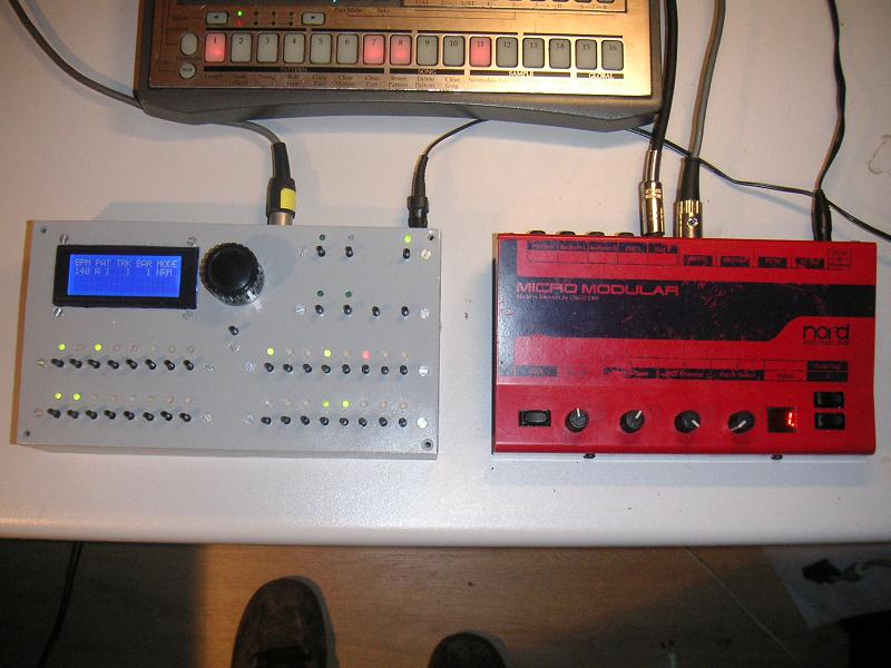

- Sequencer runs!
- Fixed sequencer mute track bug
- Some tracks didn't send the note off messages correctly, corrected
- Bankstick error handling added
- Default pattern is loaded when no BS is available at startup
- Note length/divider is implemented
- Independant length/divider for each track
