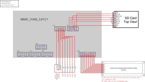

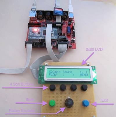

A detented rotary encoder and 6 buttons are directly connected to J10 of the Core module to control the menu system.In addition a LCD is required. The recommended size is at least 2×20! Graphical LCDs (GLCDs) are supported as well.
