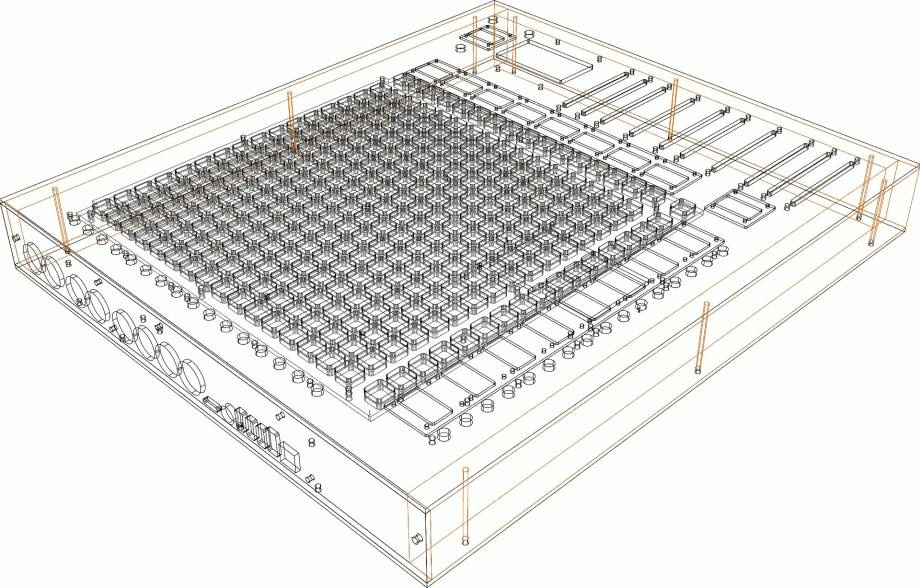

first renders off Triggermatrix V5
TM-V5 uses custom PCBs
17 Screens now driven by the Display driver PCB
So the Matrix-Cells get names now in X and Y view
Trigger-Output on 5V Level (before it was all midi only)
Trigger-Input on 3V, 5V or Mic-Preamp-Level
The whole Device will be a bigger because of Extra Screens and because of 2×16 3.5 Trigger JAcks…
